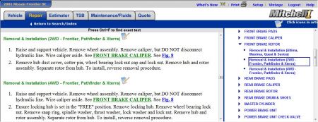

Is the a specialize tool required to remove the rotor?

See below
https://images.2carpros.com/forum/automotive_pictures/12900_rotor1_1.jpg
