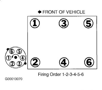

FIRING ORDER
TJBASSETTI
MEMBER
2000 NISSAN FRONTIER
6 CYL
4WD
MANUAL
123,000 MILES
What is the firing order?
Monday, September 21st, 2009 AT 12:20 PM
BLUELIGHTNIN6
MECHANIC
16,542 POSTS
SPONSORED LINKS
+16
Monday, September 21st, 2009 AT 12:22 PM
