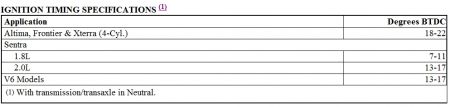

I have replaced the distributor 3 times now and it overheats and stops getting spark, ultimately shutting down. It gets so hot you cannot touch it, for that matter the whole engine seems to run hot however the temp gauge never shows hot.

Is check engine light coming on? Seems as though your timing may be incorrect.

I would lean toward incorrect timing over a wiring issue here. Shorted wiring to ignition coil would not explain engine overheating, incorrect timing can cause engine overheating as well as dist. Overheating

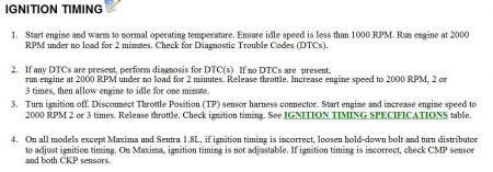

Is the timing adjustable or set? Under the impression that it is preset in distributor?

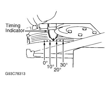

Ignition timing is adjustable on the Frontier..

I will be trying this tomorrow and hope this is it. If not I will let you know. If so I will definitely be donating thank you. Thank Goodness for lifetime warranty on distributor.
