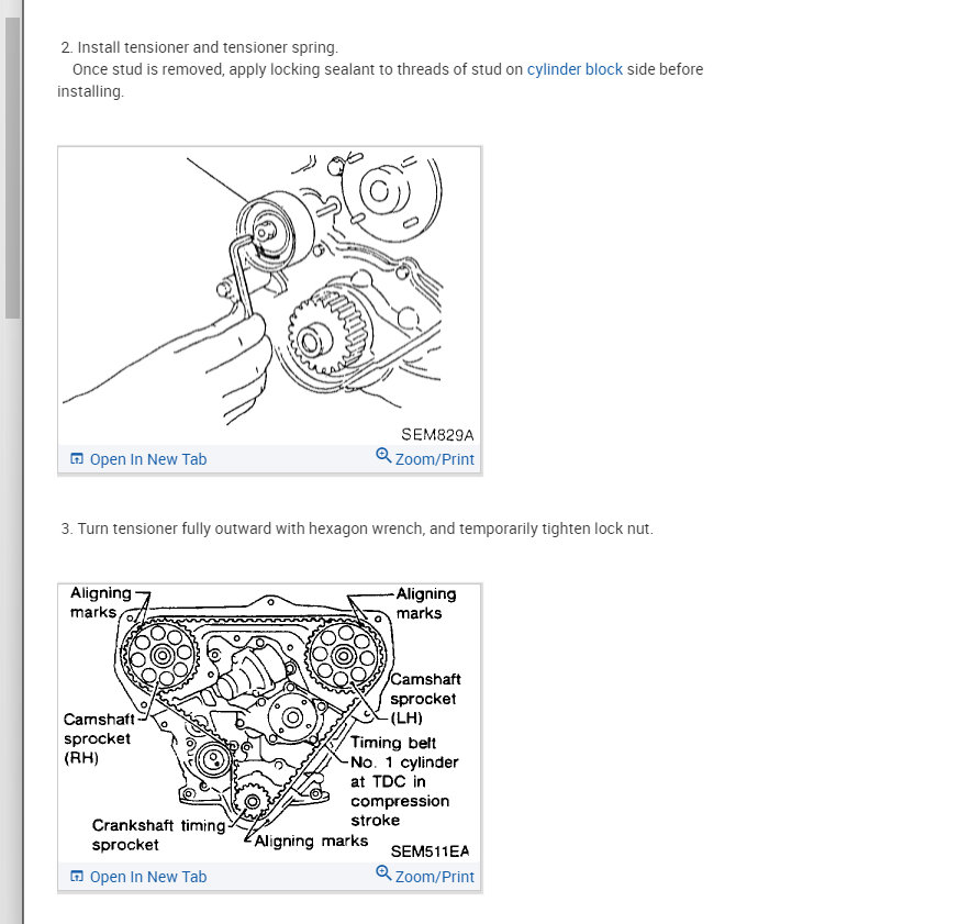

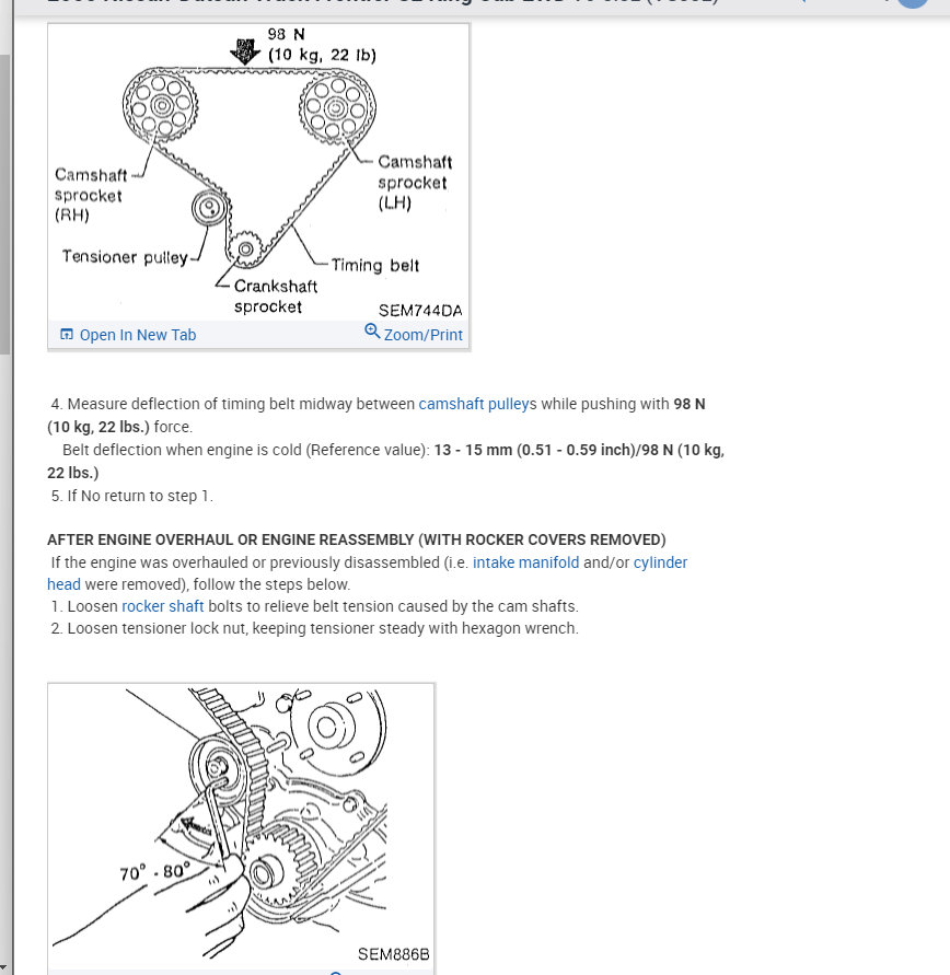

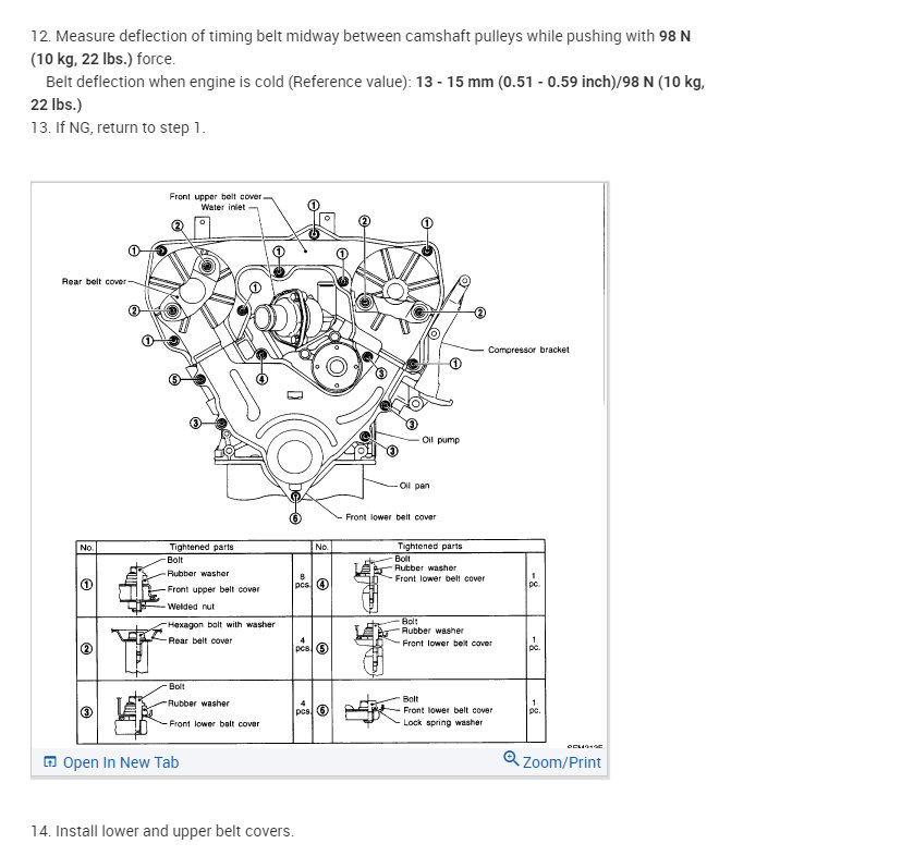

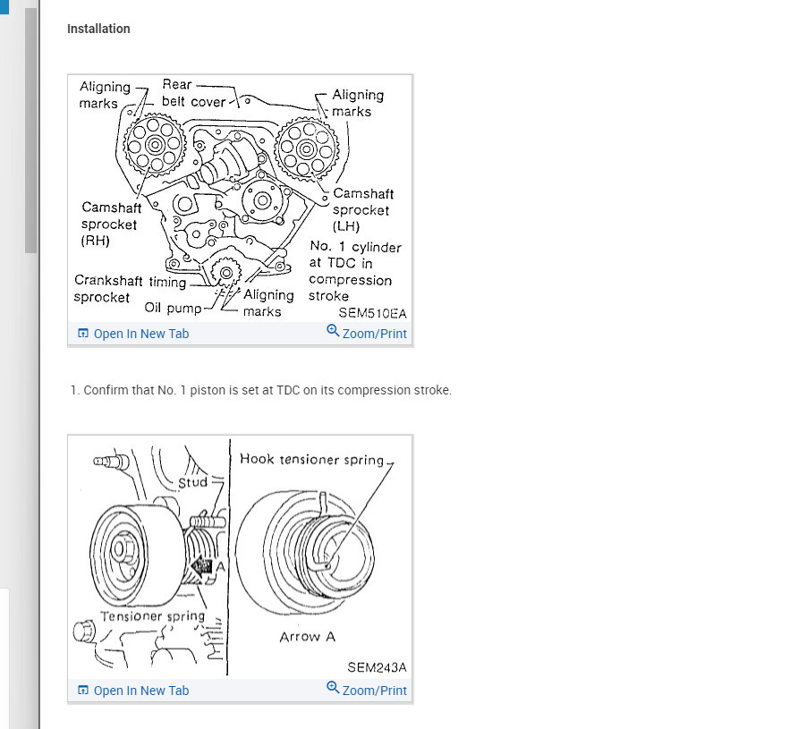

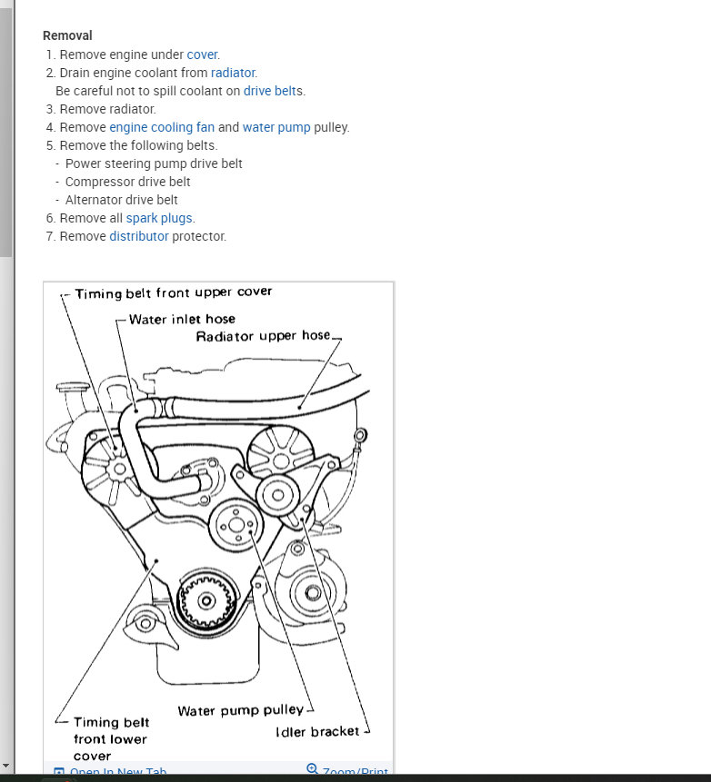

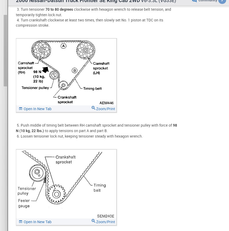

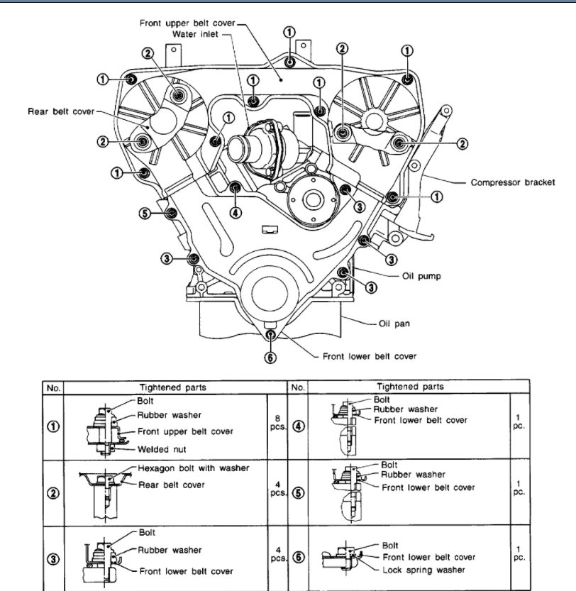

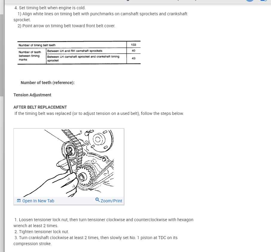

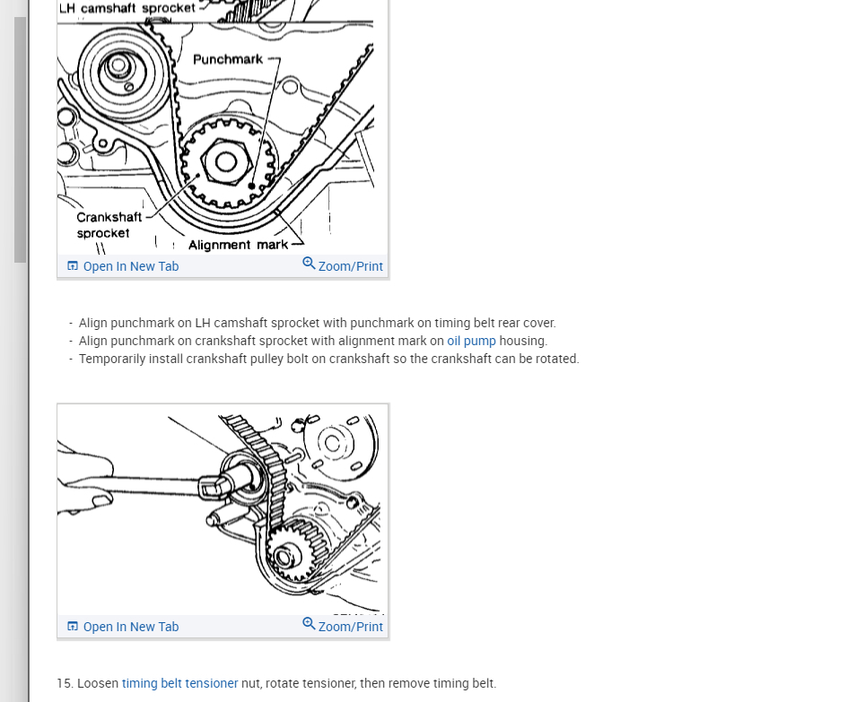

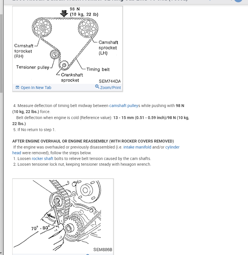

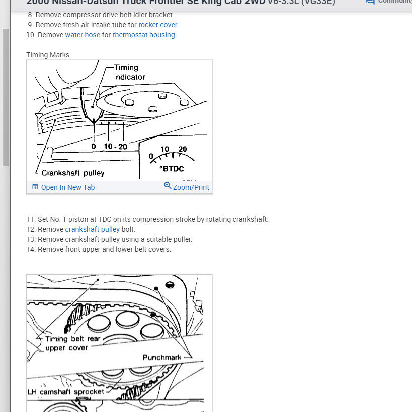

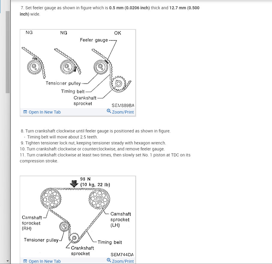

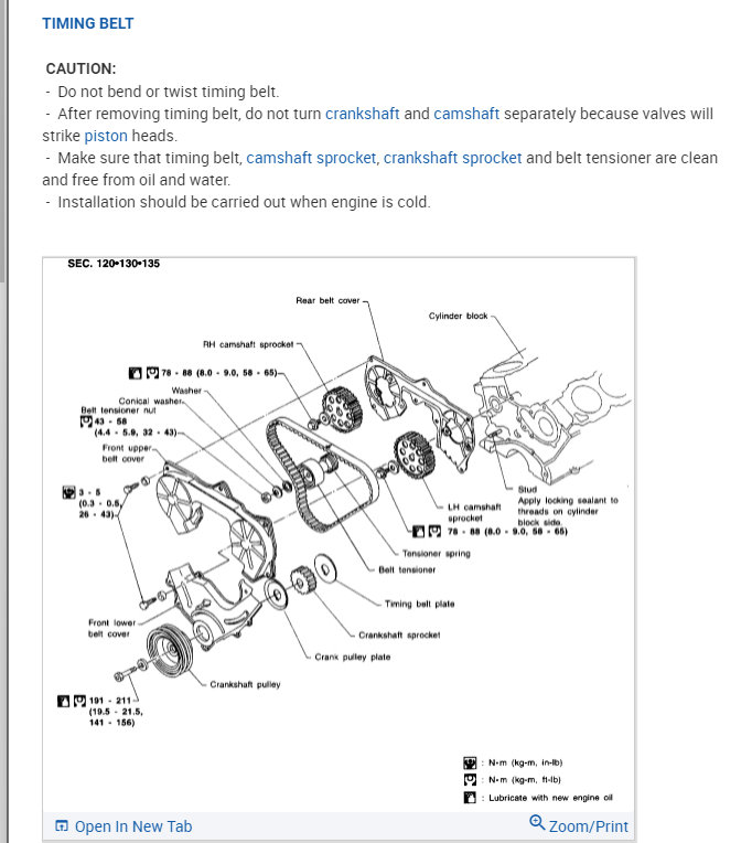

Help! I need diagram for changing timing belt. Any suggestions?
Mar 17, 2010 at 9:35 AM
The fact that you want the diagram for the timing belt and not a chain you most likely have the 3.3L engine as the 2.4L has a timing chain.
So, I will attach the info below on this but here is a guide that will help with this:
https://www.2carpros.com/articles/serpentine-belt-timing-belt-timing-chain-diagrams
Please see the attached info and let us know what questions you have. Thanks
