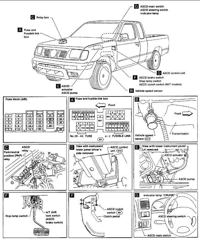

I installed a new battery and now the brake lights (both tail and high) remain on at all times even with ignition switch off. No warning lights show on dash. I have removed the fuse to save battery. The rotors were replaced. I have had no problems until the battery was replaced yesterday.

I am not sure at this point if the battery has anything to do with the brake switch as it does not seem to be connected, it may just be a coincident.
So for now let's not think the battery/brake lights are connected and focus on just the brake light.
Check your brake light switch on the brake pedal. it may be out of adjustment or broken internally. Try the adjustment below, but first before working on the brake pedal adjustment make sure the switch is okay. Pull up on the brake pedal and see if the switch plunger is sticking in and pull it out as far as it will go and see if the lights go out. If they do not then press the brake pedal and release see if they stay on and check to see the distance of the plunger to the pedal and again ensure the pedal is out verse the switch is bad.
STOPLIGHT SWITCH & AUTOMATIC SPEED CONTROL DEVICE SWITCH
1. Both switches are located below dash panel, at brake pedal bracket. Adjust brake pedal height. See BRAKE PEDAL HEIGHT and BRAKE PEDAL FREE PLAY .
2. Check clearance and position of switches. Clearance between brake pedal stopper rubber and threaded end of switch should be 0.01-0.04" (0.25-1.0 mm). To adjust, loosen lock nut and turn switch body. After adjustment, tighten lock nut.

It does sounds like the brake light switch here is a diagrams on where it is. Also there is no relay so you don't need to worry about it sticking on.

Hi, You Need To Replace The brake light switch.Have Your Mechanic Install it. It May be To Difficult, for you to install.

Sounds like it could be the switch at the pedal, or a bad ground in the cicuit.

the brake light switch is most likely culprit causing brake lights to remain on at all times
