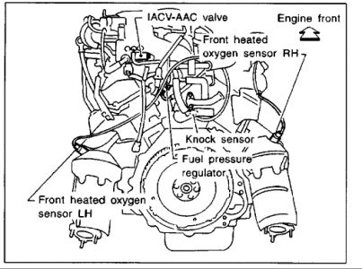

2000 Nissan Frontier 6 cyl Two Wheel Drive Automatic
where is it locatced? by the fule rail? and how hard is it to change?

https://images.2carpros.com/forum/automotive_pictures/12900_fpr_24.jpg
Fuel Pressure Regulator Check 1.Stop engine and disconnect fuel pressure regulator vacuum hose from intake manifold.
https://images.2carpros.com/forum/automotive_pictures/12900_f1_4.gif
2.Plug intake manifold with a blind cap. 3.Connect variable vacuum source to fuel pressure regulator.
https://images.2carpros.com/forum/automotive_pictures/12900_f2_3.gif
4.Start engine and read indication of fuel pressure gauge as vacuum is changed. Fuel pressure should decrease as vacuum increases. If results are unsatisfactory, replace fuel pressure regulator. https://www.2carpros.com/kpages/auto_repair_manuals_alldata.htm
