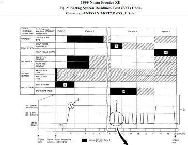

recently when i took my truck to have it smog check it failed badly and it was labeled as a gross polluter. So they suggested for me to change my egr valve. i took it to a mechanic and he said he replaced it with a used egr valve. evrything seems to be running okay. actually my truck drives perfectly after the replacement. but when i took it to the smog check it won't pass the readiness test, According to them the egr system, oxygen sensor and the catalsyt reads that it's not ready yet. I drove it around for 60 miles and came back and still the same problem. so what happened? What can i do to make it pass smog check? Please help I'm desperate!

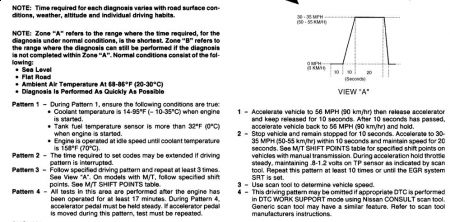

Follow the appropriate drive cycle.
https://images.2carpros.com/forum/automotive_pictures/30961_nisobddc_1.jpg
https://images.2carpros.com/forum/automotive_pictures/30961_nisobddc1_1.jpg
