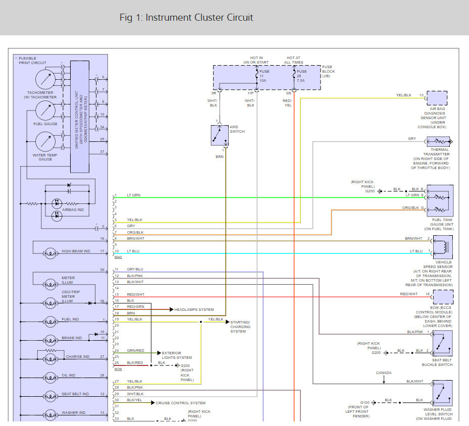

I have noticed that the speedometer occasionally does not work. 3 days ago it would read 40mph and stay stuck there regardless if I were driving faster, but it would drop to zero after coming to a stop. No engine light comes on the dashboard. Today it is working fine. Is the problem with the speedometer sensor or speedometer head? No other instruments/gauges are affected. Is there a way to test if the sensor is good or bad without buying a new one and replacing it?

See diagram
https://images.2carpros.com/forum/automotive_pictures/452729_Fontier_Speed_Sensor_Troubleshooting_1.jpg

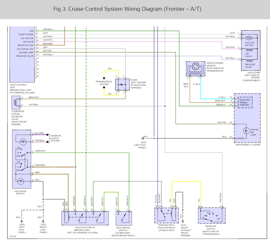

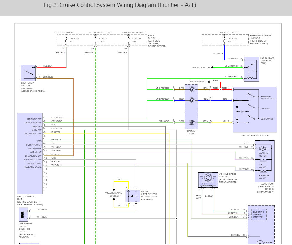

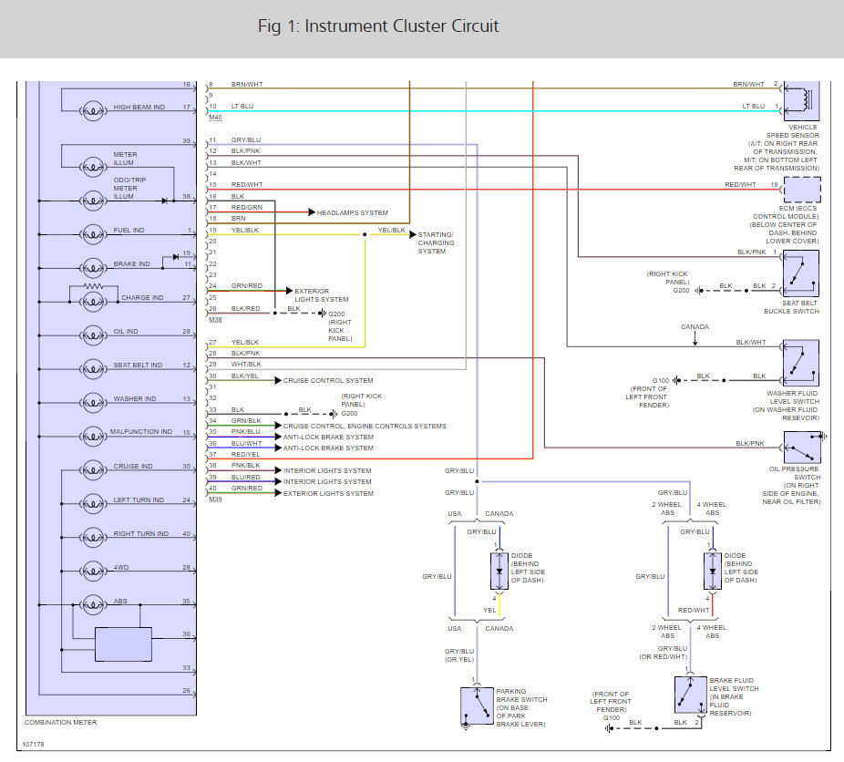

It sounds like you have a vehicle speed sensor that is going out though I have seen bad connections do this as well. Remove the cluster and unplug it. Then plug it back in again. This will clean the connections helps the cluster work again. Here are some wiring diagrams so you can see how the circuit works.
Use the guide to check the wiring
and this to test the fuses
