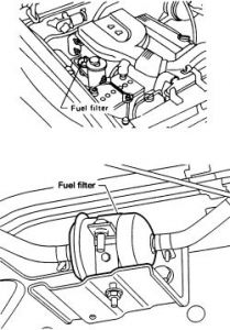

whats the procedure for changing fuel filter??

The fuel filter is located under the vehicle near the fuel tank. Relieve the fuel system pressure. Remove the fuel filter shield, if equipped. Disconnect fuel lines. Remove fuel filter from the bracket. To install: Install or connect the following: Fuel filter to the bracket Fuel lines Fuel filter shield, if equipped Start the engine and check for leaks.
