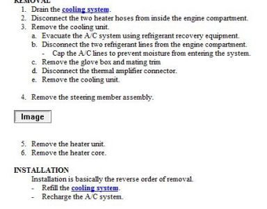

Heater problem
1998 Nissan Frontier 4 cyl Two Wheel Drive Manual
How do you replace the heater core on a 1998 nissan frontier 4 cylinder?

https://images.2carpros.com/forum/automotive_pictures/139033_2carpros_2.jpg
