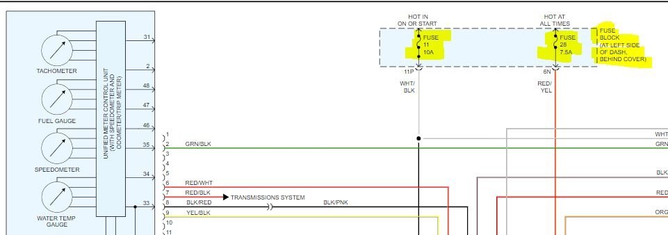

Very loud motor revving when in higher gears.. very little power when climbing.. also just the other day all my dash instruments went crazy; no temperature gauge, no odometer and no gas hand.. but the instrument lights still come on so does radio.

When you say, high engine revving when in high gears, and there is very little power, it sounds like the clutch is slipping. Does that seem logical to you at this point? Also, is the vehicle running since the gauges all acted funny? I need you to check a couple fuses for me. See picture 1 for location and fuses. I highlighted them.
Here are a few links to help if needed:
Let me know what you find with the fuse, your thoughts on clutch issues, and if the check engine light stays on when the engine is running.
