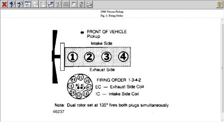

firing order Z24 1985 nissan please...thank you very much

There you go
https://images.2carpros.com/forum/automotive_pictures/12900_fo_datsun_2.jpg
