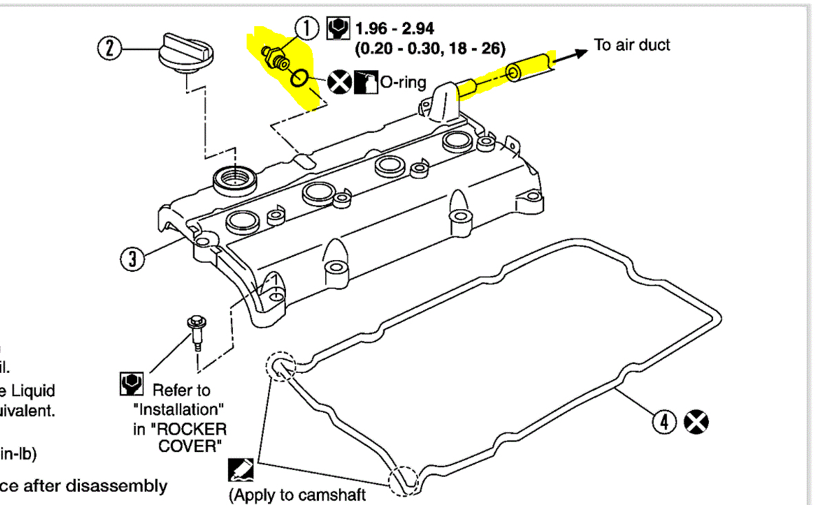

I have just noticed oil being blown out the oil cap, so I took it off while it was running, and it has a lot of air blowing out. is there a cause for that or is that post to be normal? I've never run into that before. i found no vacuum leaks. I'm going to have code scanned and will update but will be tomorrow before I can. thank you for help guiding me through this. it has been colder out than normal and it's not doing it so bad until the car has been driven for a while but in warmer weather it does it as soon as you start the car.

That shouldn't be happening. It is normal to have some air come out with the cap off, but not blow oil out of the cap.
When an engine is running, it produces crankcase pressure. That pressure is released via what is called a PCV valve (positive crankcase ventilation). Basically, engine vacuum draws the air back through the engine for re-burning.
The PCV valve is located on the valve cover. I attached a pic below of it. I need you to first confirm the hose to it isn't cracked or plugged at either end. Next, remove the PCV valve and check to see if it is plugged.
Let me know what you find. Also, you mentioned the top end of the engine was rebuilt. Was this your engine or a different one? Do you know how many miles were on it?

I checked the PCV hose and valve the hose still look good PCV valve looks to be clean-ish very oily. The installation under hood is soaked in oil of course it all over valve cover plus alternator and fuse box under hood it blows quite bit more while accelerating.it has approximately 175,000 to 200,000 miles I got the car from a good friend of mine he had a second Altima that he switched the whole front clip only thing you didn't change was the motor mounts and all of them are bad I've worked on another of motors but never had one blow the cap off just by loosening it I loosened it to see what it would do it blow the cap off. I'm use to older engines, not really familiar with imports though. Thanks for all the help. I know it's all a process of eliminating I've never run into a problem like this one as I was running it today it it didn't have as rough of an idle it was still doing it just not as bad when I went to park it for the evening it was getting worse with running a load the fan and radio is what was on it seemed to have more power than it has had. I have found no vacuum leaks. I know it has a new idle control sensor and a couple other sensors are nearby. I'm going to ask him tomorrow which one supposed to be, but I don't think anything was ever done with the PCV valve all hoses under the hood was put back new when had motor swap it was done about a year ago last time codes where read it said misfire on number 1 or 2 I think it's said oxygen I'm going firt thing in morning to have them re-read them I will update as soon as it's done again thank you caes it's really got me stumped.

Make sure the PCV hose isn't plugged. Most times when hoses are replaced, they are the smaller ones and not the PCV. Remove it and try blowing through it. Also, the same with PCV.
What is happening sounds like blow-by. When the compression rings or cylinders wear beyond a certain point, compressed air escapes past them causing excessive crankcase pressure. If the hoses are all clear, we will need to do a compression test.
