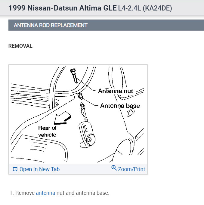

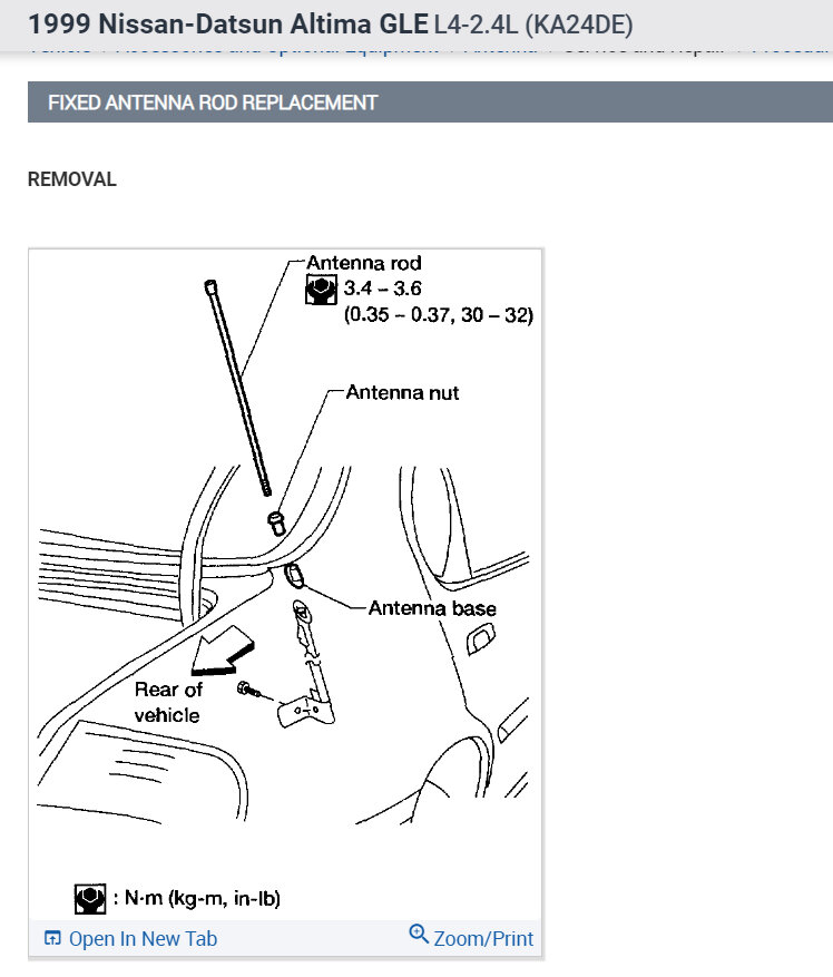

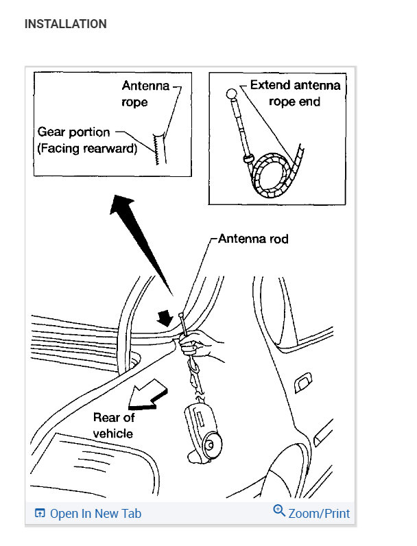

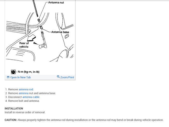

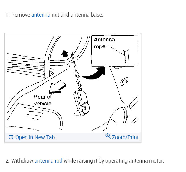

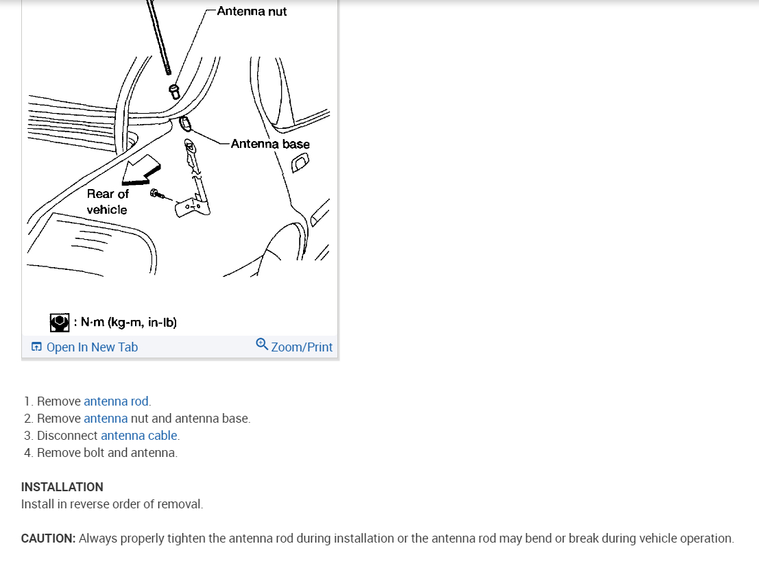

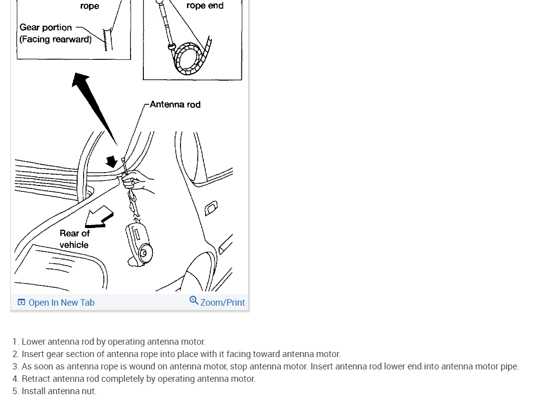

How do I change the power antenna on a 1999 Nissan Altima? Iwas broken off flush with the base and the plastic strip that pushes the mast was also broken off at the base.
Feb 2, 2007 at 9:30 AM
SERVICE WRITER
  • 9,123 POSTS
There are two different kinds of antenna so I have included them both in the images below. Check out the images (Below). Please let us know if you need anything else to get the problem fixed.
