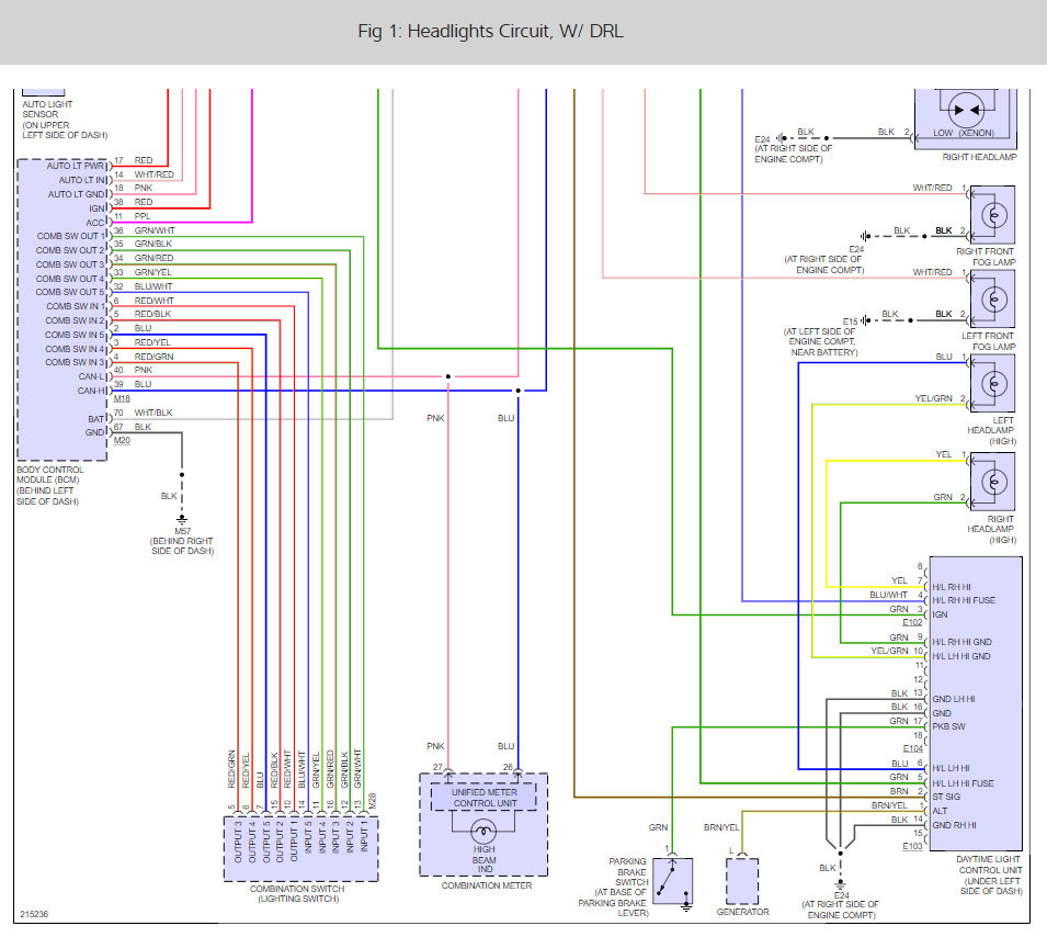

Four cylinder front wheel drive automatic 60,000 miles.
My low beam driver side headlight is out. I replaced the bulb but the headlight is still not working. Could there be another problem beside the bulb?

Have you checked the fuse and the relay?

Is there power to the socket?
Yes, it is possible that bulb number two could be bad also (I have seen shipping and handling in action).

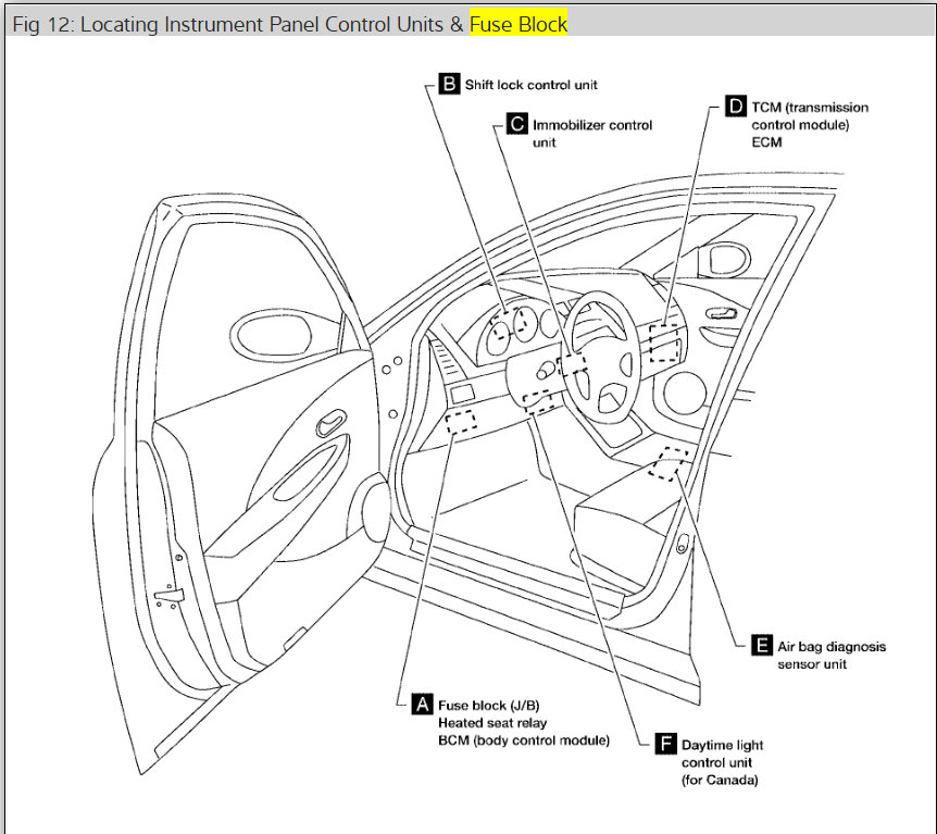

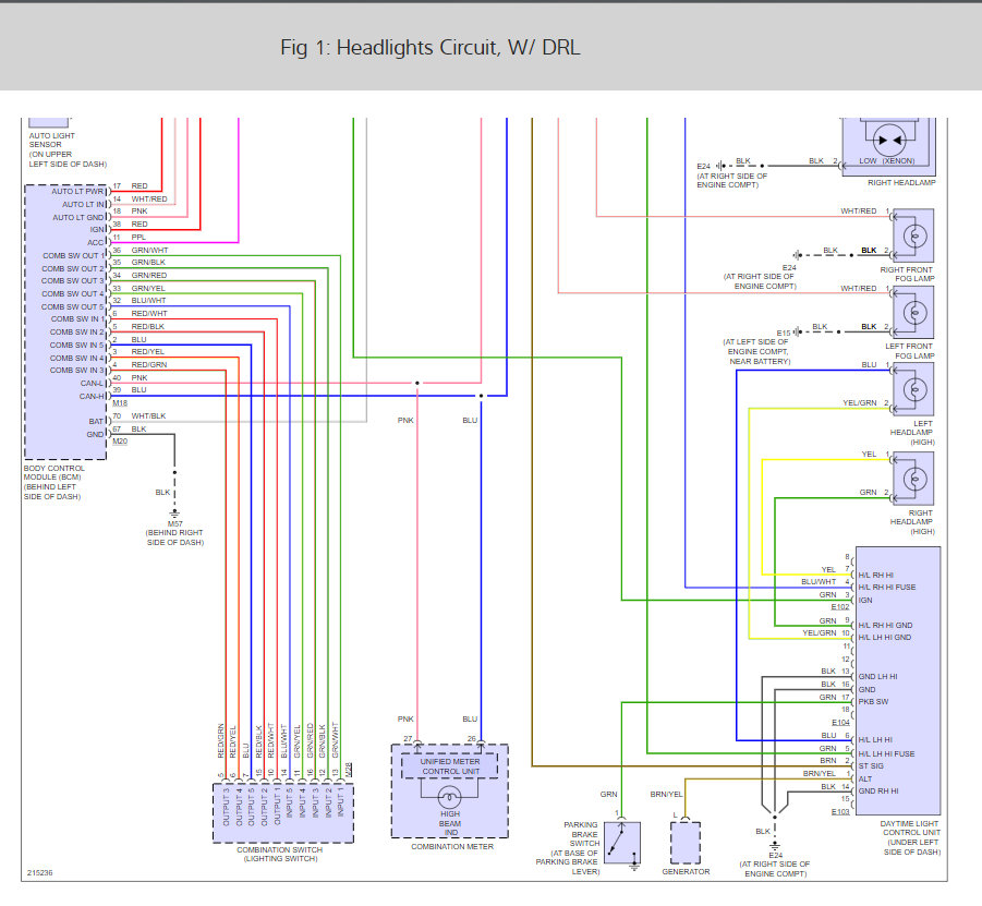

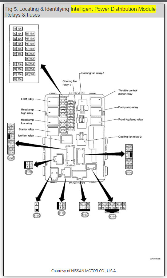

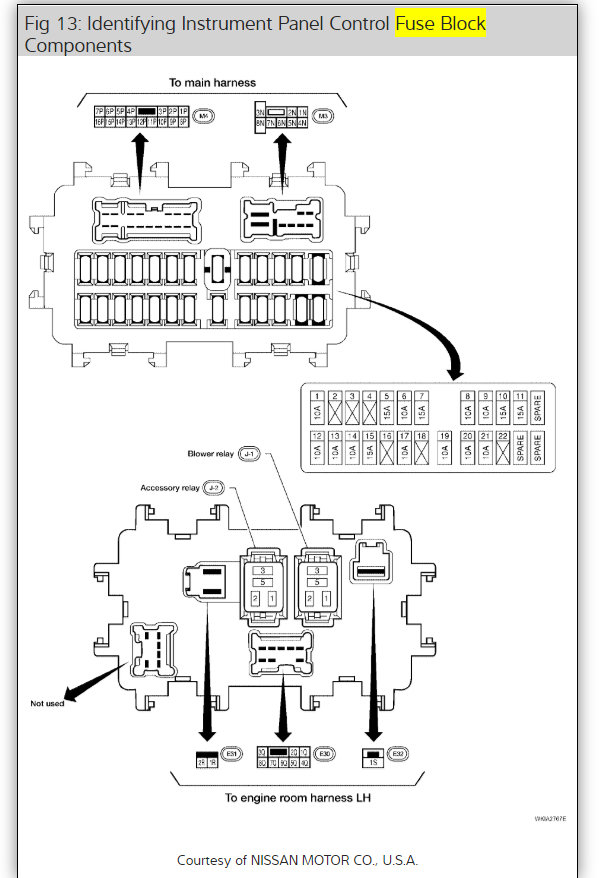

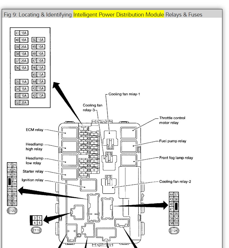

If one light works and the other doesn't then it could be the fuse. We should check the fuse and check for power a the fuse then at the socket.
Here are some guides to help us do some testing to figure out what the problem is.
and
and
https://www.2carpros.com/articles/how-to-replace-a-headlight-bulb

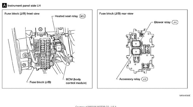

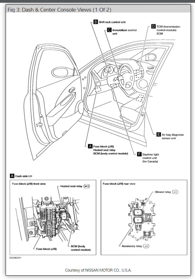

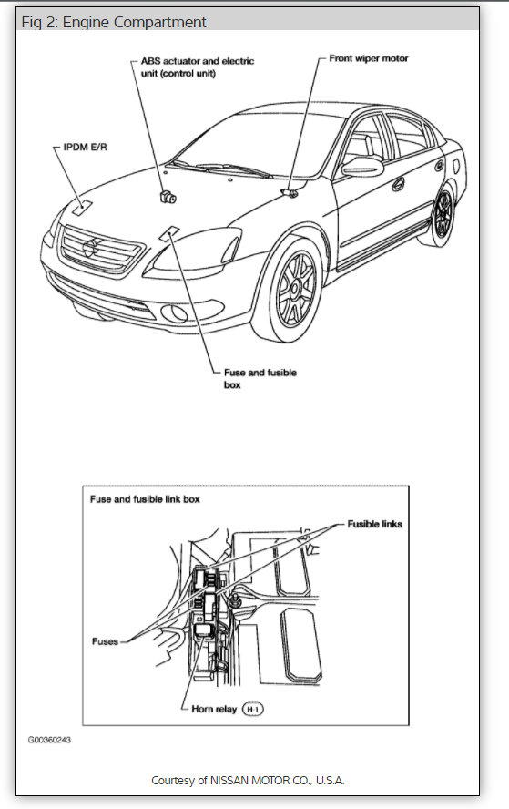

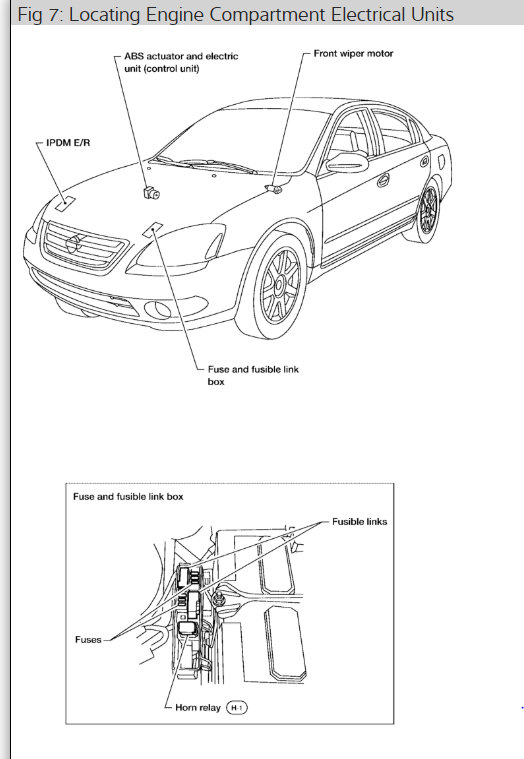

Here are some diagrams (Below) to help us get started.

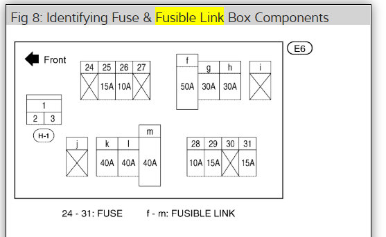

Fused seperately. use test light see if power to lights.
Somtimes one burns out you don't notice and sometime later the other goes making it look like both blew at once.

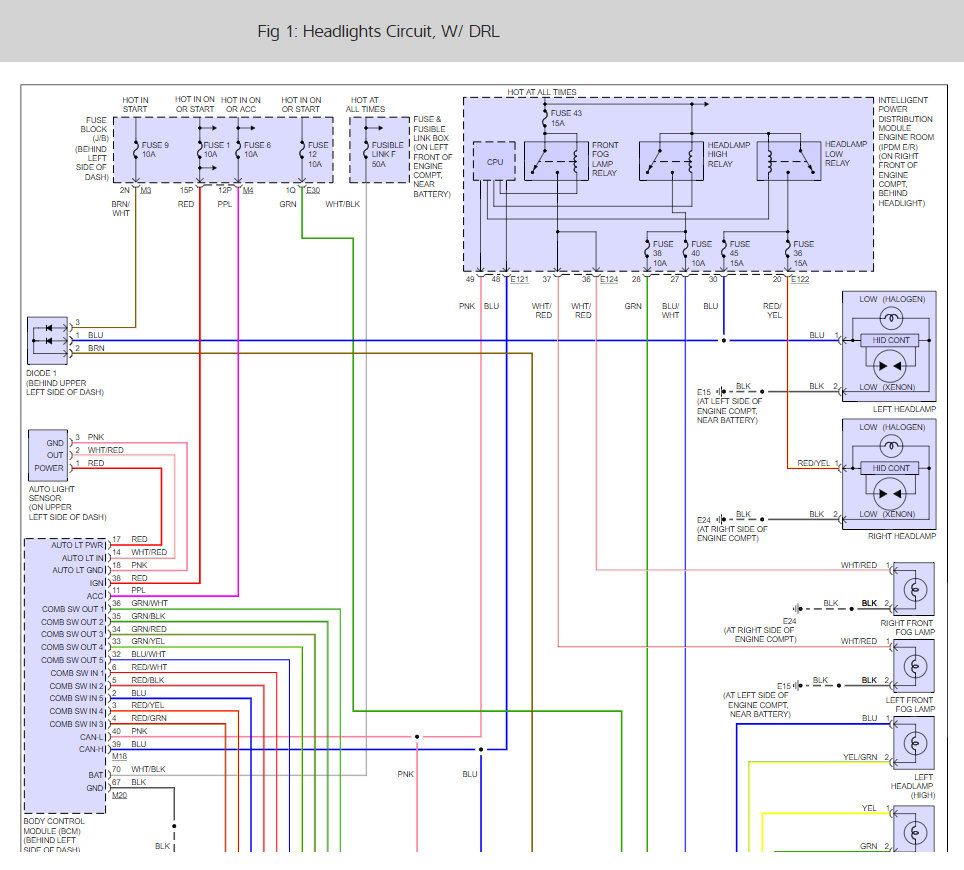

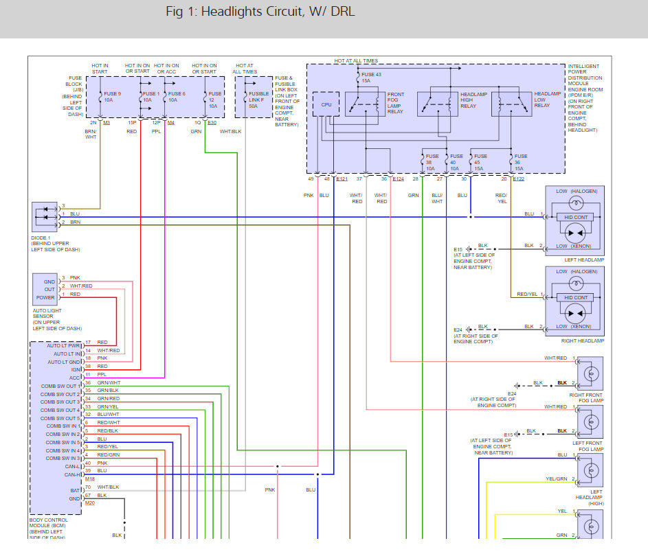

There are five fuses that run the system check out the guide below to show you how to test for power and there are headlight wiring diagrams below as well so you can see how the system works.
Check out the diagrams (Below). Please let us know what you find. We are interested to see what it is.
Mar 11, 2019 at 5:59 AM (Merged)
OIDAVEY
  • 0 POST
Thanks for this post I did some testing and found a bad connection at the bulb! FYI
