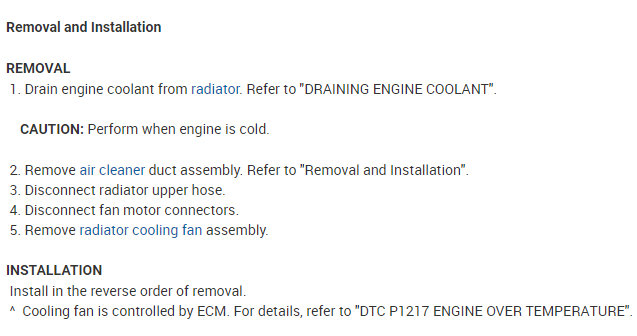

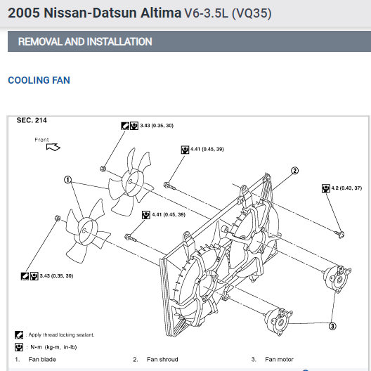

2005 NISSAN ALTIMA
How I do change the radiator fan? Thanks a lot.

Hello, I'm Danny.
Here is a tutorial showing how the cooling fans work:
https://www.2carpros.com/articles/replace-electric-fan-motor
I've attached picture steps below on how to remove and replace the cooling fan assembly for your car. Hope this helps and thanks for using 2CarPros.
