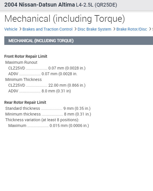

I have a 2004 Nissan Altima with 67,750 miles and needs both front and rear brakes (~10 - 15%) pad left.
Here's my question... I am being told by the shop that the rear rotors need to be replaced. The spec on the car is for .381 and they are at .415 and .413. Should I replace the rear rotors now or wait.
Apr 15, 2009 at 5:10 AM
ZACKMAN
  • 4,202 POSTS
If the rotors are not gouged or warped, just turn them to remove the "glaze". You should be OK. Just re-measure the thickness after the the machining.
Mar 19, 2021 at 3:58 AM
SQM
  • 6,383 POSTS
It is recommended to resurface the rotors when changing the pads (if they are within specification).
When measuring a rotor be sure to check few low spots to and use the lowest reading. As long it can be resurfaced and stay above the minimum thickness, it will function properly.

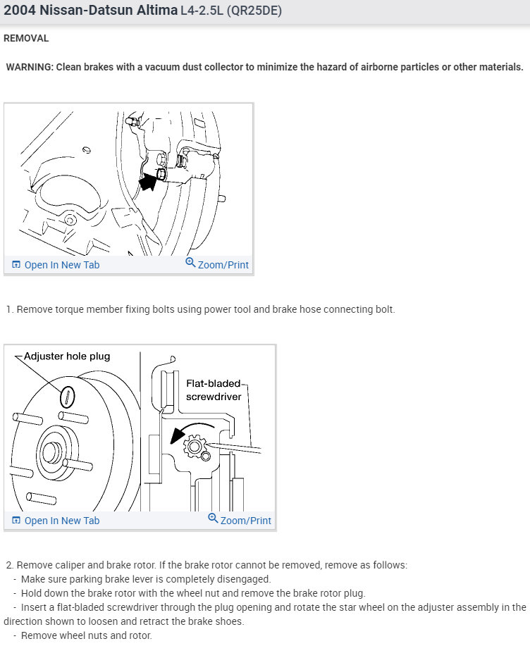

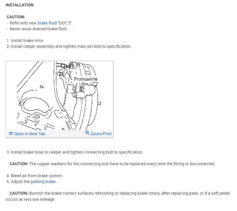

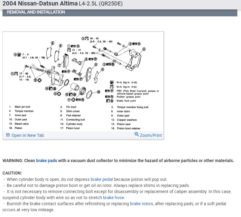

https://www.2carpros.com/articles/how-to-replace-rear-brake-pads-and-rotors
I have attached the brake replacement procedure below.
