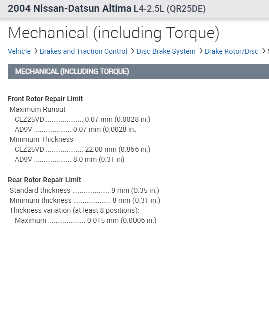

I have a 2004 Nissan Altima with 67,750 miles and needs both front and rear brakes (~10 - 15%) pad left.
Here's my question... I am being told by the shop that the rear rotors need to be replaced. The spec on the car is for .381 and they are at .415 and .413. Should I replace the rear rotors now or wait.

If the rotors are not gouged or warped, just turn them to remove the "glaze". You should be OK. Just re-measure the thickness after the the machining.

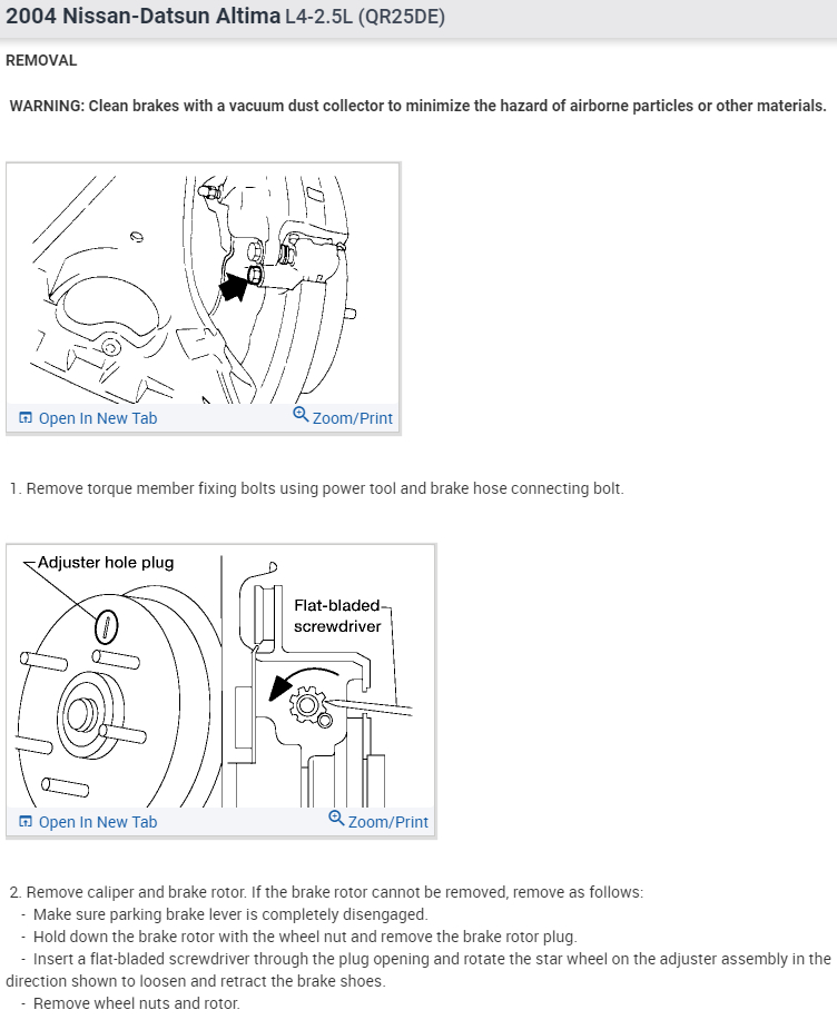

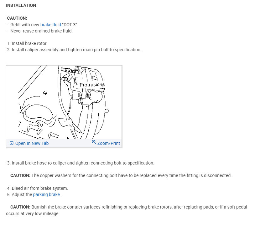

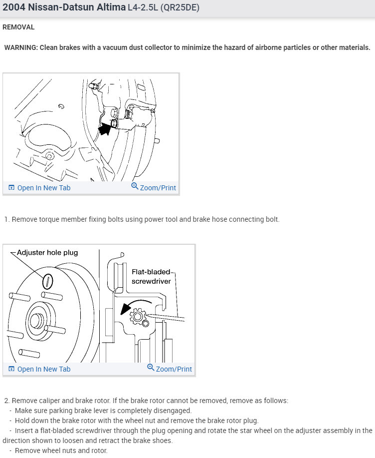

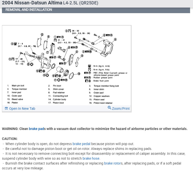

It is recommended to resurface the rotors when changing the pads (if they are within specification).
When measuring a rotor be sure to check few low spots to and use the lowest reading. As long it can be resurfaced and stay above the minimum thickness, it will function properly.
https://www.2carpros.com/articles/how-to-replace-rear-brake-pads-and-rotors
I have attached the brake replacement procedure below.
