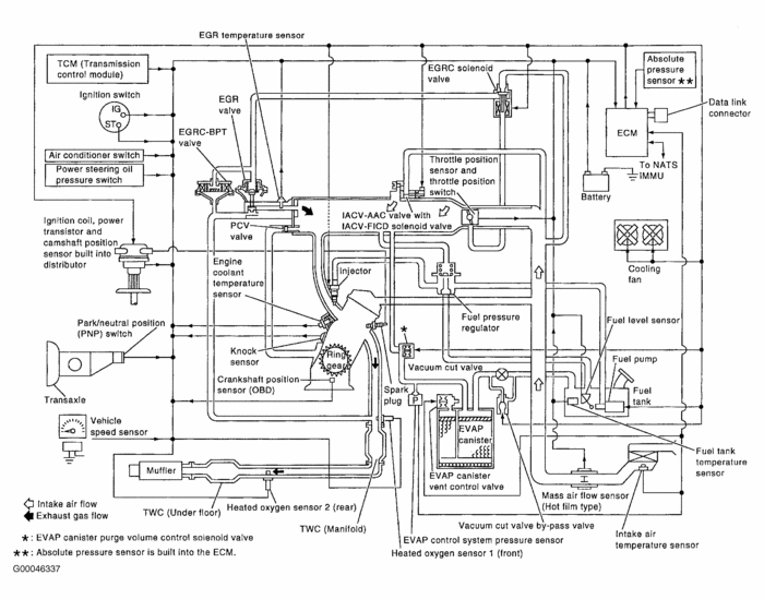

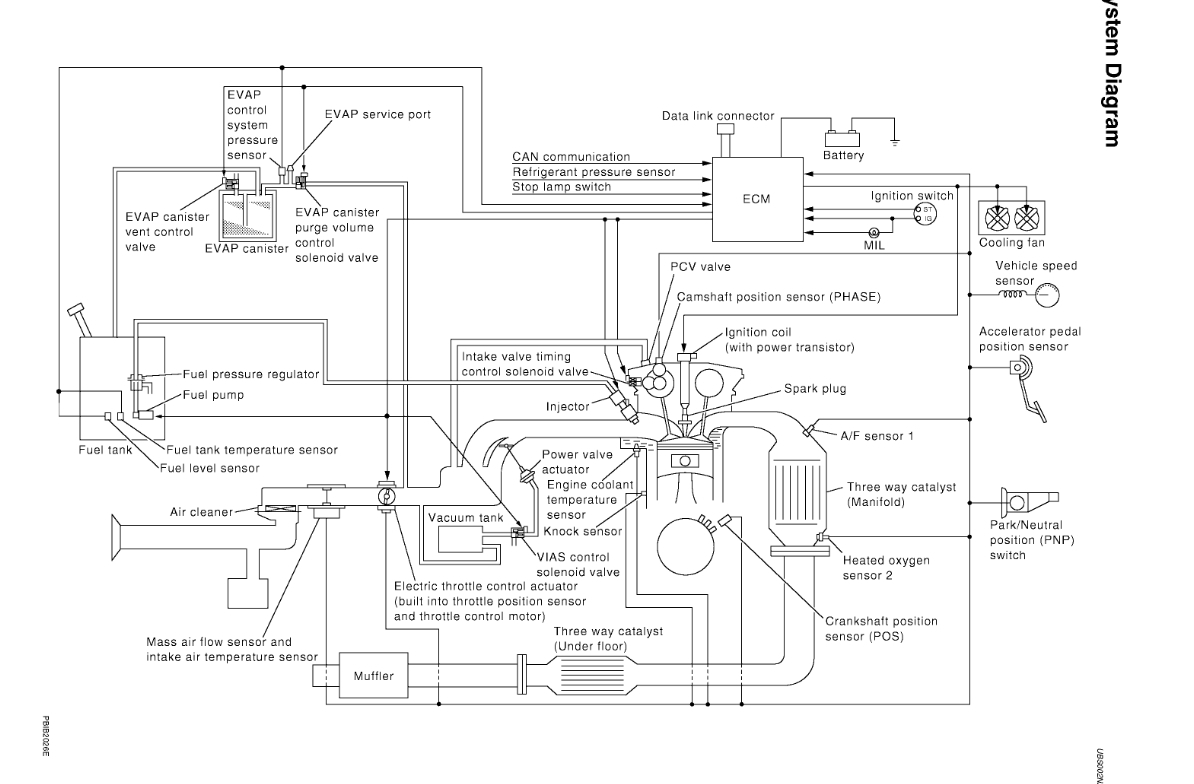

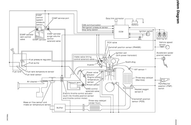

look at the back of the intake manifold, there will be a hose coming out of the valve cover, the pcv valve will be connected to the hose at the valve cover or at the other end of it. Here is a diagram. Check out the diagrams (Below). Please let us know if you need anything else to get the problem fixed.

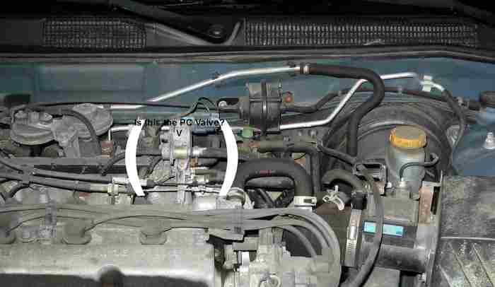

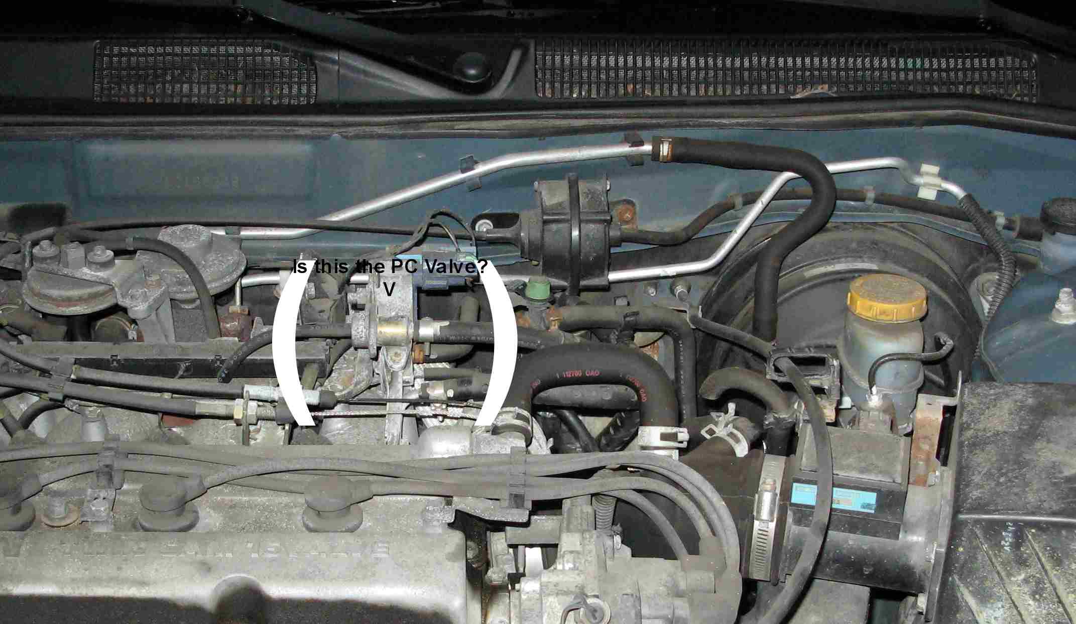

SIDJO39
Is it between the two () brackets?
May 11, 2020 at 12:05 PM (Merged)
RIVERMIKERAT
  • 6,110 POSTS
No The PCV valve is located on the other side of the engine. The image I have attached should help you locate it.
