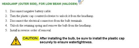

How do I remove the drivers side headlight to change the low beam bulb?
I removed to 2 top screws but the unit wont come out.

STOP!!!! No need to remove the headlamp assembly to change the bulb.
