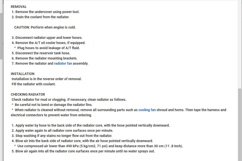

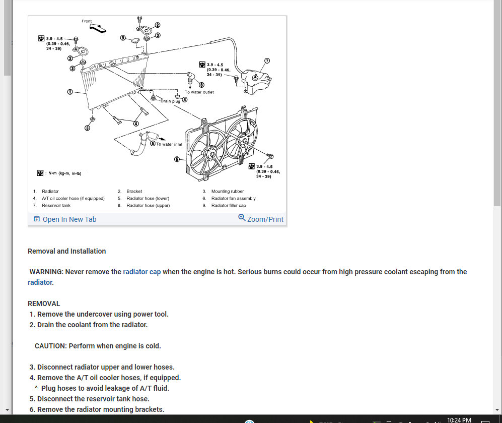

More than likely this is an issue with a radiator hose or the radiator itself. This guide will help with step by step instructions on how to replace them:
https://www.2carpros.com/articles/replace-radiator-hoses
https://www.2carpros.com/articles/how-to-replace-a-car-radiator
Below you will find the process from the manual that will help with replacing this. Please let us know if you have questions on this. Thanks
