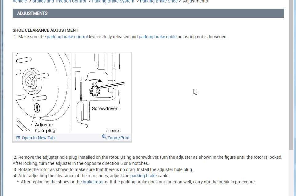

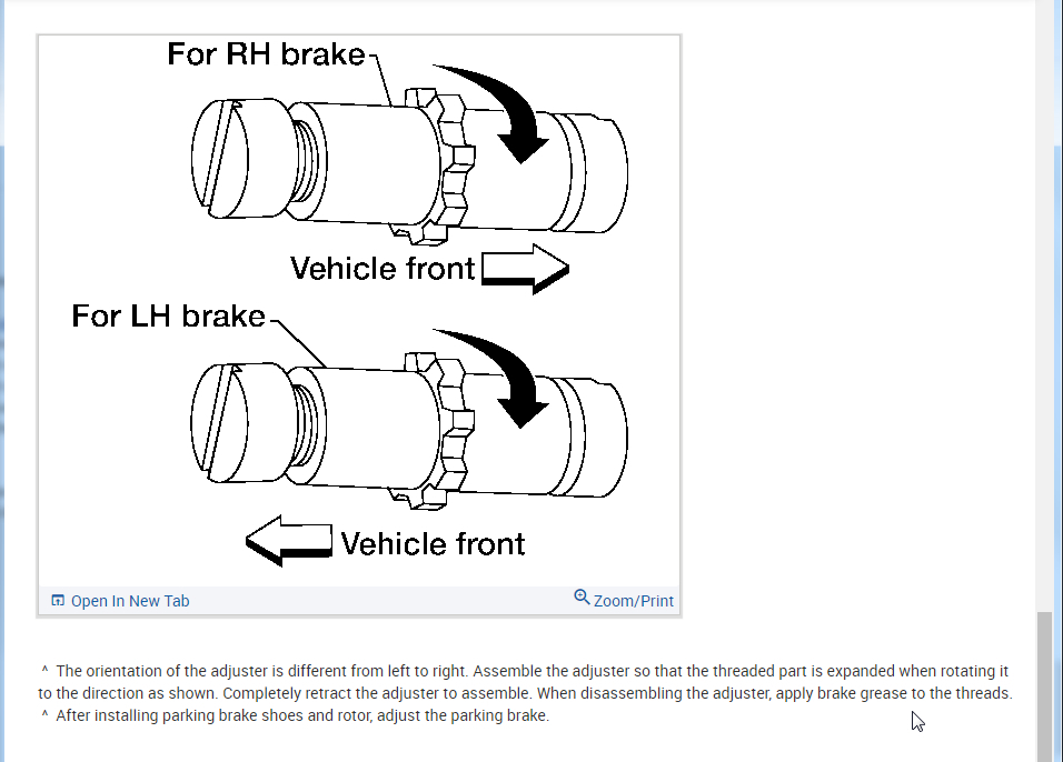

When I set my parking brake my car still rolls. The handle goes up about 7 clicks and it does engage somewhat but not completely. Any suggestions?
Feb 16, 2010 at 12:32 AM

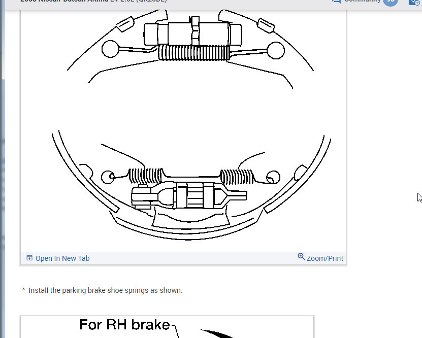

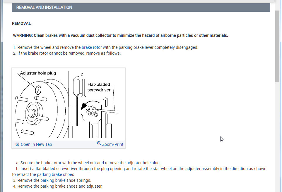

You may be able to just adjust them but if you need to replace them here is a guide that will help with this:
https://www.2carpros.com/articles/parking-brake-shoe-replacement

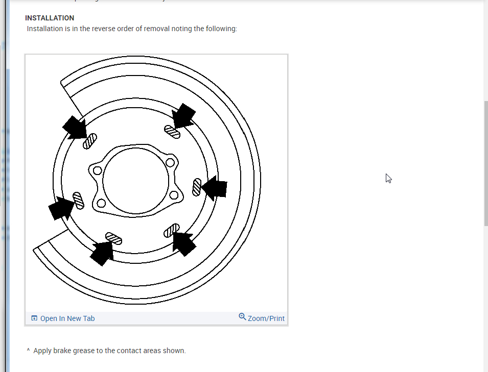

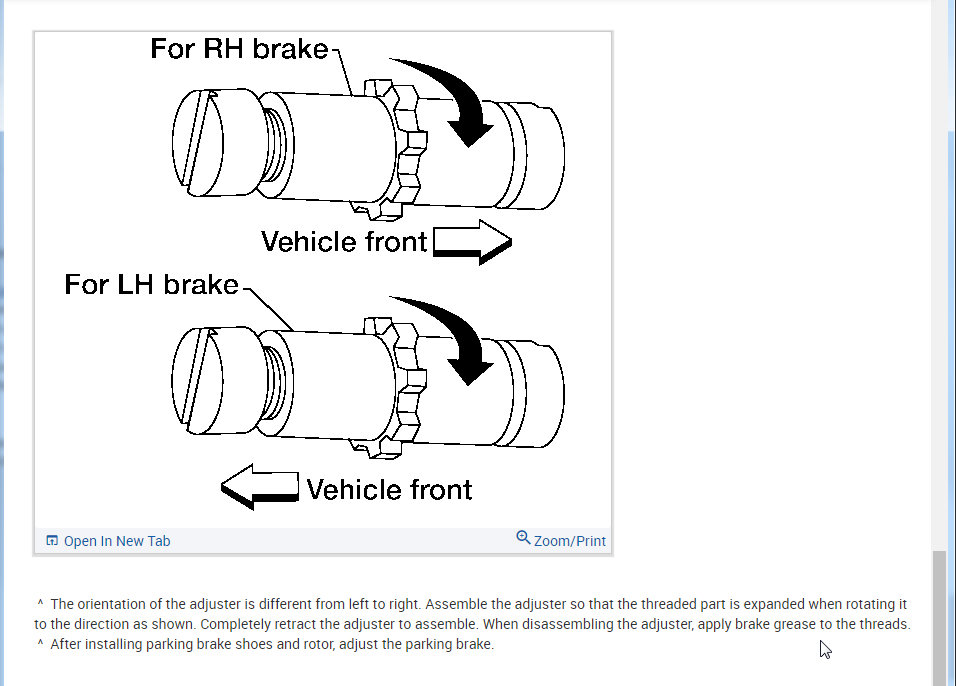

Below you will find the process from the manual on how to replace these and adjust them as needed.
Please let us know if you have other questions. Thanks
