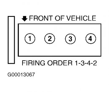

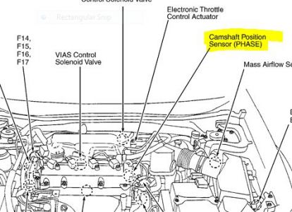

2003 Nissan Altima 4 cyl Front Wheel Drive 160000 miles
where is the cam position sensor located and what is the firing order?
