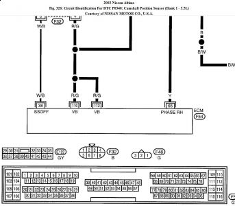

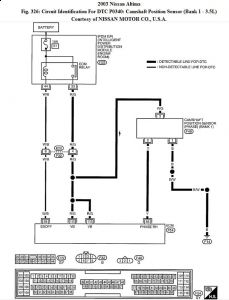

When the codes keep showing, it could either be a fault with the sensor, its wiring circuit or the PCM.
https://www.2carpros.com/forum/automotive_pictures/192750_DTCP0340AltimaFig326_1.jpg
https://www.2carpros.com/forum/automotive_pictures/192750_DTCP0340AltimaFig326a_1.jpg
Do the following test first.
Check continuity between sensor and PCM, terminal 65 ( Yellow wire).
Check the ground connections ( Black or Black/White)
Check Red/Green wire for battery voltage when ignition switch is turned ON.
Friday, May 4th, 2018 AT 10:55 AM
MIKEB57
  • 6 POSTS
Could you enlarge that schematic at all? When I do it on this end it is not clearly legible. Thanks
KHLOW2008
  • 41,814 POSTS
Sorry the site is not friendly with diagrams. I will email the schematic to you so you can have better control over it.
Hang on and it should be there soon.

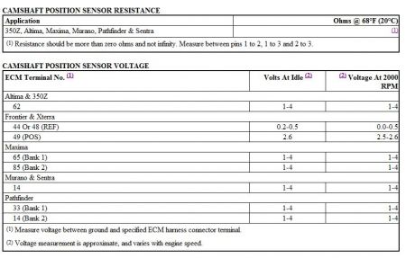

You have been very helpful. Do you have access to the list of parameters for checking ohm resistance from pin to pin on the sensor?
KHLOW2008
  • 41,814 POSTS
The main aim of this site is to help in whatever way we can and we would never turn down any questions if we can help it.
Yes, our database do have specifications for sensor resistance and voltage ranges. Let me know what you requires and I will get it for you.
MIKEB57
  • 6 POSTS
For the cam sensor previously discussed.
KHLOW2008
  • 41,814 POSTS
Here you go. Hope it is legible. This site is not too friendly with diagrams and are often resized too small.
https://www.2carpros.com/forum/automotive_pictures/192750_CamSensorSpec03altima_1.jpg
