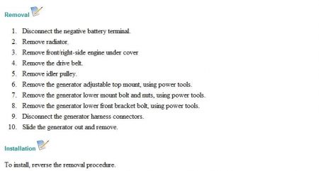

How do you remove the alternator from my 2020 Altima. I have removed the radiator and fender well cover but i dont no where to go from there.
