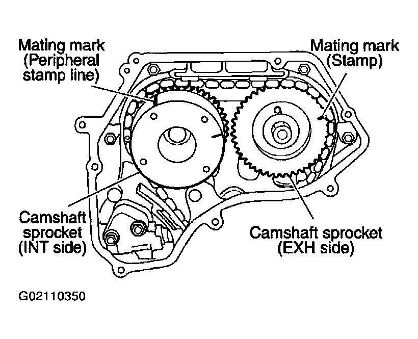

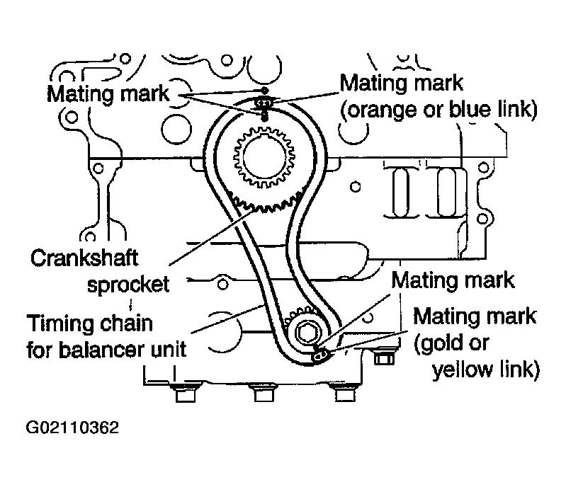

Hello 2carpros,

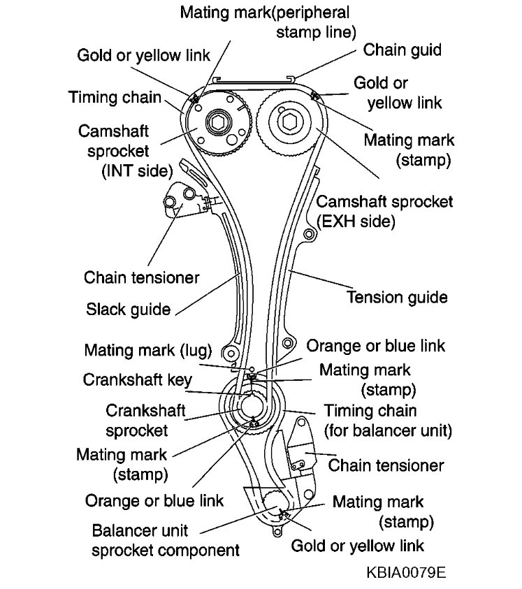

I am wondering where to get a timing chain diagram for my car? It has the 2.5 engine. I need it to finish up the head job my mechanic left me, he had to go away for a family emergency. I have tried the instructions from a few manuals already, but they did not feature the 2.5 engine. They only talked about the 2.4, which is a different diagram.
I need your help, thank you.
Fixsky
Feb 8, 2009 at 7:33 PM
BLUELIGHTNIN6
  • 16,542 POSTS

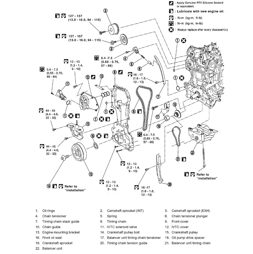

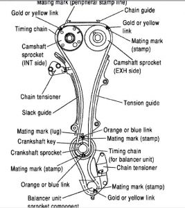

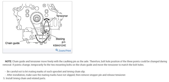

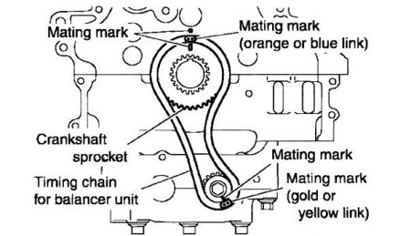

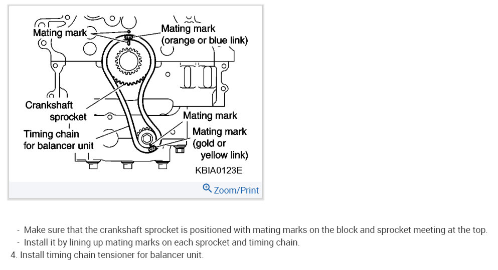

Hello, Timing marks are below for the 2.5L engine. Check the diagrams (below) If you need further assistance just let me know. Balancer timing chain alignment marks-2.5L engine.
https://images.2carpros.com/forum/automotive_pictures/261618_Noname_230.jpg
Timing chain alignment marks-2.5L engine
https://images.2carpros.com/forum/automotive_pictures/261618_Noname_231.jpg

Head gasket replaced, lost timing in sprockets, after many tries, have TDC right
chain yellow marks aligned each camshaft okay, according to diagram. See no marks in cover except drill mark on cover exhaust cam, near 10 mm bolt.
Intake cam mark at 9 o'clock .
Have compression 130 approximately.
Turned engine on, no luck removed and grounded spark plug no fire!
Plugged scanner and shows cam sensor failure and air fuel metering problem.

DASILVA111
Shows code P1111 and P0340. Car was running fine just for burn exhaust valve (replaced).
My question still is, proper way to align cams? had TDC and the two yellow marks in chain to mating marks in sprockets but after turns by hand, will not match again.
Is firing mark number one in slot of intake cam is to be exactly aligned with sensor.

DOCFIXIT
  • 18,828 POSTS
Timing chain marks 26 links between gold/yellow mark on chain and 64 links between camshaft sprocket and gold/yellow link and crankshaft sprocket orange/blue link on the timing chain side without the tension-er. See diagrams.
Were codes present before head removal? And injector pulse?

DASILVA111
As I explained earlier, there were no codes engine was running but missing on cylinder three, valves were changed.
Now code again 1111 and 0340.
I seen diagrams before and installed chain according to diagrams.
Number one cylinder TDC yellow marks on top and sprocket marks on each yellow mark.
Any other suggestions?
Is it possible, no fire because camshaft not in position with spark sensor?

DOCFIXIT
  • 18,828 POSTS
P0340 fault in camshaft position sensor either open or shorted or out of phase located on rear head is it plugged in wiring intact?
P1111 fault Intake valve timing control either defective or open or shorted IVTC has to be removed during repair must not be disassembled. Is solenoid connected wiring intact?

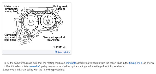

DASILVA111

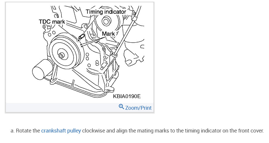

Got car started after turning engine by hand several times
and matching yellow mark in chain and sprockets, this is what I did;
number one cylinder TDC aligned with mark bottom cover and two yellow marks on top of chain.
Then turned ex cam and intake cam to go in slots no luck.
So I moved two teeth on each cam and started but missing badly, if I repeat that what should be position of EX and INT lobes?
Is it possible that chain slipped at crank couple of teeth? If so is there any other way to set timing?
I am lost and see no way out.
Aug 22, 2018 at 12:20 PM (Merged)
DOCFIXIT
  • 18,828 POSTS
May need to start from step one make sure number one cylinder is at TDC compression stroke. Take out plug have helper turn engine by hand finger in plug hole when feel compression set on mark. TDC can align on crank to mark for TDC of number one and BTC number one may be timing on opposing cylinder.

I took the timing chain off my wife's car because I had to replace a head gasket. Now I am trying to get the timing chain back together. I have it on the cam shafts and I am have it lined up on the starting marks in all three places. My question is, is that just a starting point or will the marks line up again after x amount of motor revolutions?
KHLOW2008
  • 41,814 POSTS
Hi brittonadams,
You are correct. The marks will realign themselves after a certain number of revolutions.
