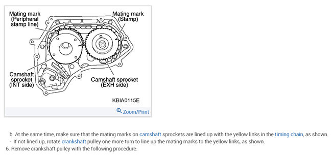

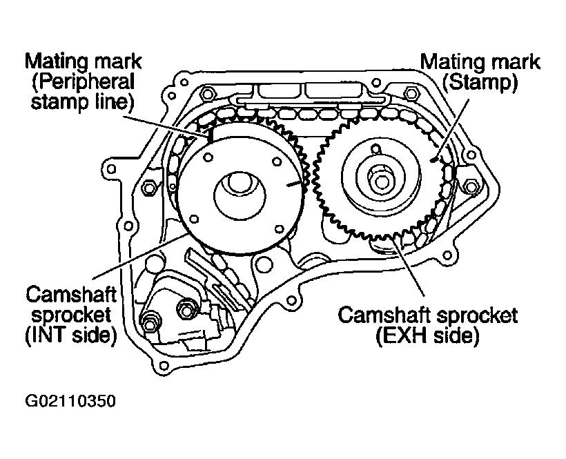

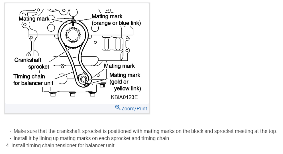

Hello 2carpros,
I am wondering where to get a timing chain diagram for my car? It has the 2.5 engine. I need it to finish up the head job my mechanic left me, he had to go away for a family emergency. I have tried the instructions from a few manuals already, but they did not feature the 2.5 engine. They only talked about the 2.4, which is a different diagram.
I need your help, thank you.
Fixsky
Feb 8, 2009 at 11:33 AM
BLUELIGHTNIN6
  • 16,542 POSTS

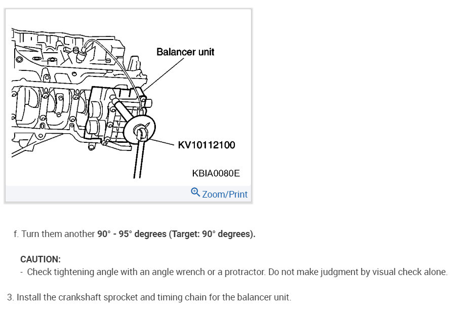

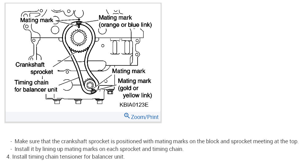

Hello, Timing marks are below for the 2.5L engine. Check the diagrams (below) If you need further assistance just let me know. Balancer timing chain alignment marks-2.5L engine.
https://images.2carpros.com/forum/automotive_pictures/261618_Noname_230.jpg
Timing chain alignment marks-2.5L engine
https://images.2carpros.com/forum/automotive_pictures/261618_Noname_231.jpg

Head gasket replaced, lost timing in sprockets, after many tries, have TDC right
chain yellow marks aligned each camshaft okay, according to diagram. See no marks in cover except drill mark on cover exhaust cam, near 10 mm bolt.
Intake cam mark at 9 o'clock .

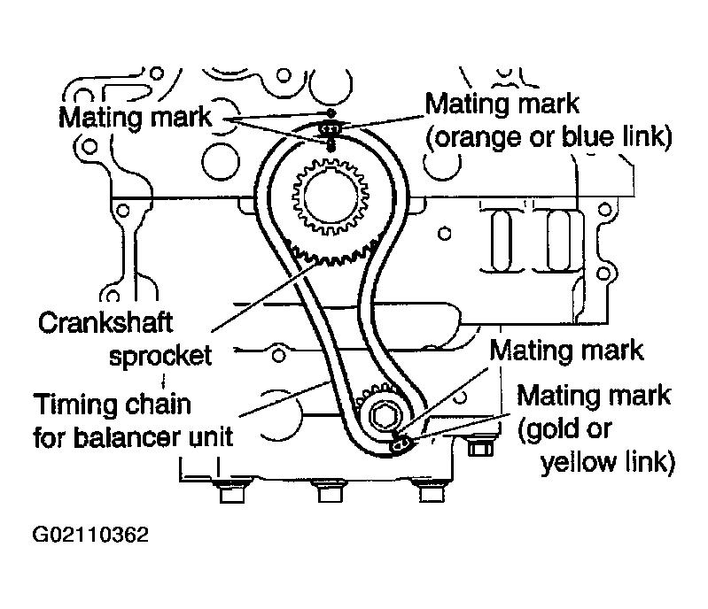

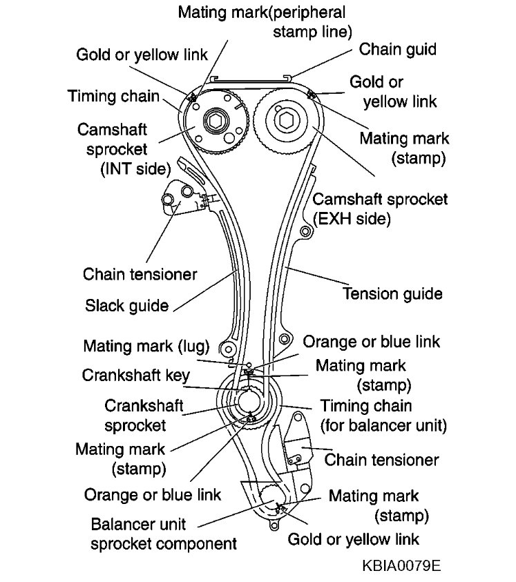

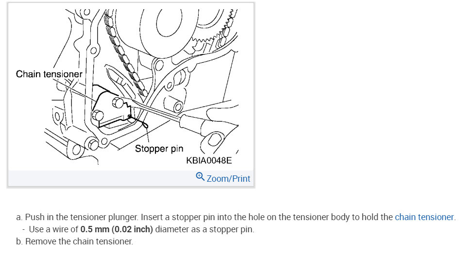

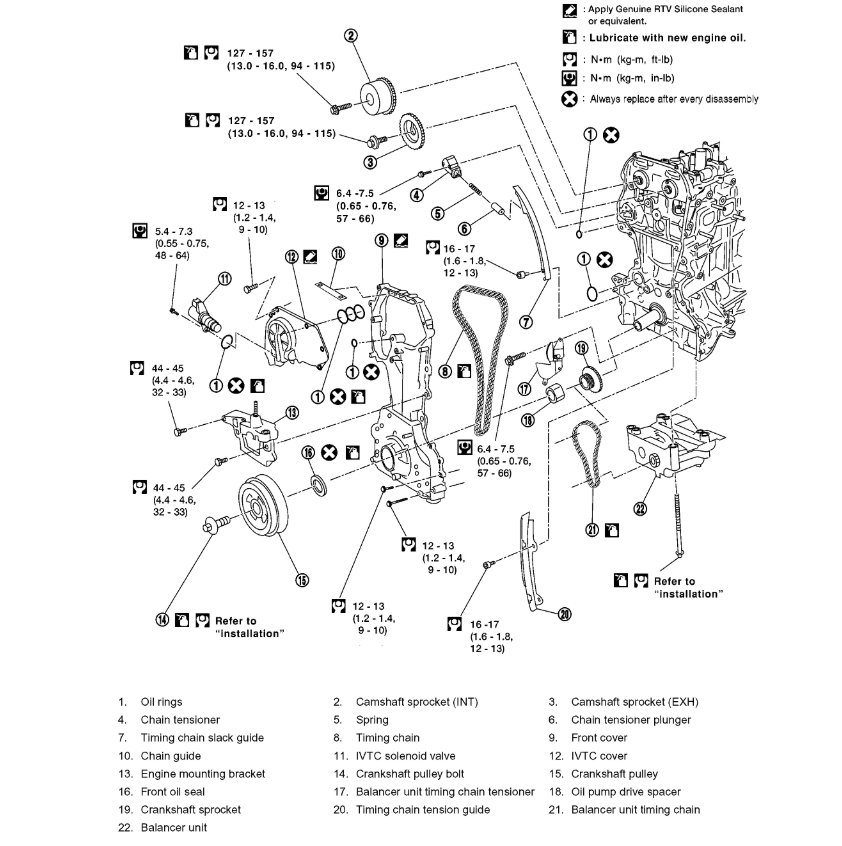

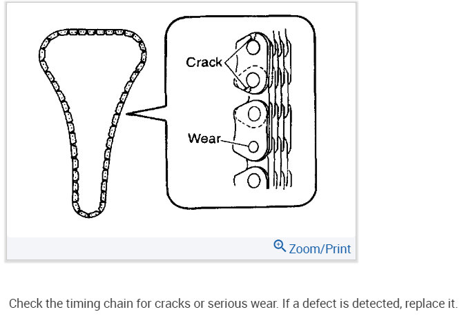

Timing chain marks 26 links between gold/yellow mark on chain and 64 links between camshaft sprocket and gold/yellow link and crankshaft sprocket orange/blue link on the timing chain side without the tension-er. See diagrams.
Were codes present before head removal? And injector pulse?

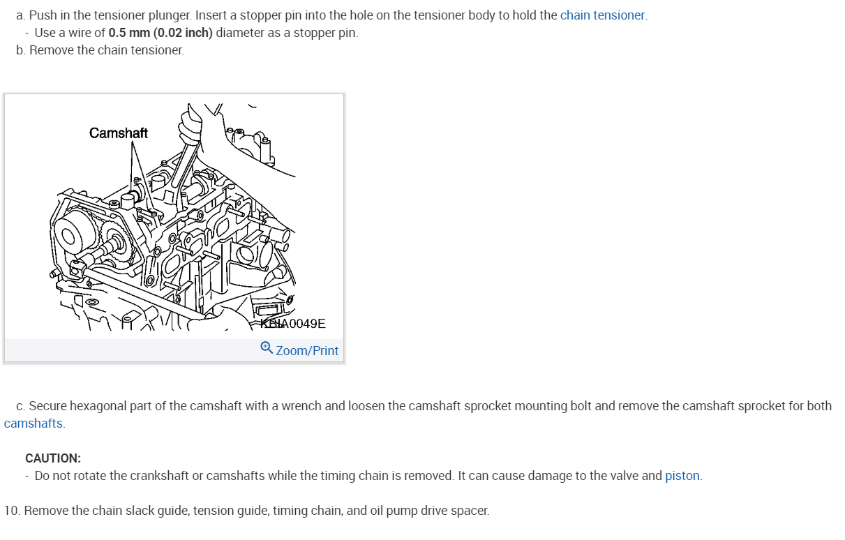

Got car started after turning engine by hand several times
and matching yellow mark in chain and sprockets, this is what I did;
number one cylinder TDC aligned with mark bottom cover and two yellow marks on top of chain.
Then turned ex cam and intake cam to go in slots no luck.
So I moved two teeth on each cam and started but missing badly, if I repeat that what should be position of EX and INT lobes?
Is it possible that chain slipped at crank couple of teeth? If so is there any other way to set timing?

May need to start from step one make sure number one cylinder is at TDC compression stroke. Take out plug have helper turn engine by hand finger in plug hole when feel compression set on mark. TDC can align on crank to mark for TDC of number one and BTC number one may be timing on opposing cylinder.
