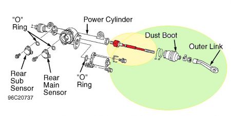

2001 Nissan Altima 4 cyl Front Wheel Drive Manual
how do you replace the passenger side inner tie-rod on a 2001 nissan altima

Require special tool
remove outer tie rod end
remove nut and remove inner tie rod end boot
use the special tool and remove the inner tie rod end
