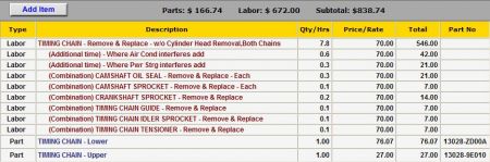

How many hours is it supposed to take to replace the Timing Chain for a 2000 Altima? Are there other items that should be replaced while the engine is semi disasembled? Roughly how much should the parts cost?

Hello Thanks for the donation. Around 8 hours to remove and replace your timing chains (both upper and lower) at an experienced repair shop. Estimate is below for removing and replacing timing chains along with the additional parts that you may want to consider replacing during this repair.
https://images.2carpros.com/forum/automotive_pictures/261618_Noname_268.jpg
https://images.2carpros.com/forum/automotive_pictures/261618_Noname2_82.jpg
