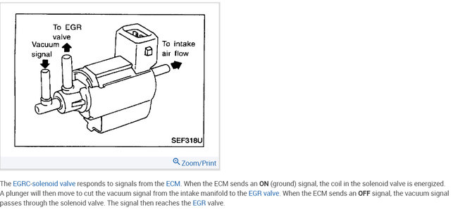

I recently got a P1400 code on my 2000 Nissan Altima so I changed the EGR Valve hoping that would be the fix, but the code stayed on even after taking it to Autozone and getting the code deleted twice. The car before i change the EGR valve was dying at ever stop now after it still dies but not so frequent. Its also shaking and was not shaking before I first got the P1400 code. Can't be the motor mounts because I had them replaced so my guess is it has something to do with the EGR system.

Hi arturocisneros,
For P1400, it is the EGR Control ( EGRC ) solenoid and not the valve that is at fault I would cehck the valve and check the vacuum lines to makes sure that are attached and not broken.

Thanks! It was the vacuum line the valve was okay, solve the engine running problem as well :)
