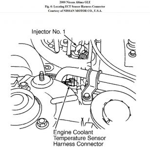

Trying to replace coolant temp sensor (bad MPG due to wrong input to ECM) and coolant temp sending unit (weird gauge behavior). Anyone got pictures of where these are? Is this worth doing? Is the voltage regulator a possible suspect? (Does the Gen2 Altima even have a voltage regulator, I can't find it!)

Hi g_gonye, Engine Coolant Temperature sensor is located at left side of engine , near fuel injector # 1.
https://images.2carpros.com/forum/automotive_pictures/192750_ECT00AltimaFig06_2.jpg
The gauge problem is more likely to be a fault with the meter cluster . There have been other reported cases of such. The voltage regulator is inside the alternator assy.

Thanks KH. The picture is very helpful. How do I narrow down the problem? How would only one gauge have a problem and how would that affect MPG, idle and performance (also crappy since alternator failure). I need specific teests I can do besides buying and replacing...

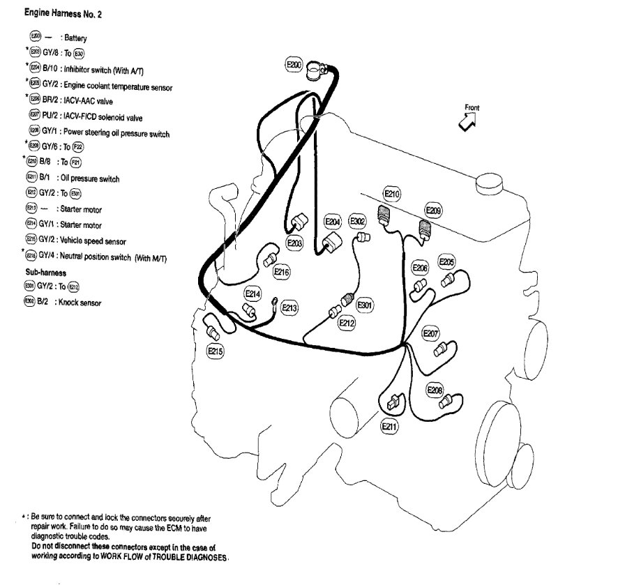

It sounds like the coolant sensor is going out we should start that first here is a guide to walk you through the repair and use the diagrams above for the location.

Inspect and test the engine coolant temperature sensor/loose connection here is a guide to help walk you through the coolant sensor replacement with diagrams below to show you where the sensor is on your car.
