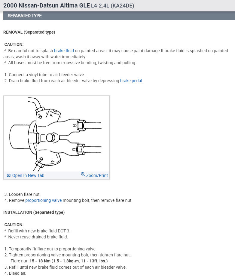

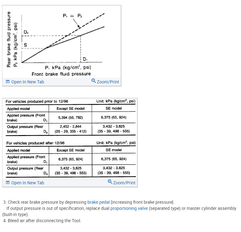

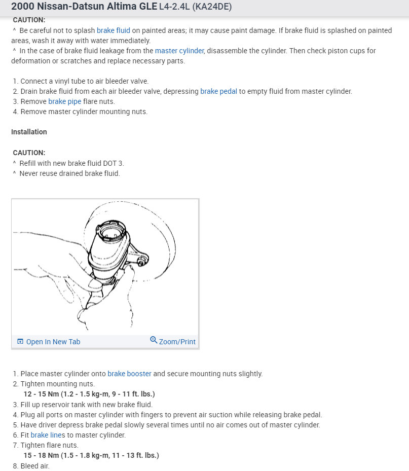

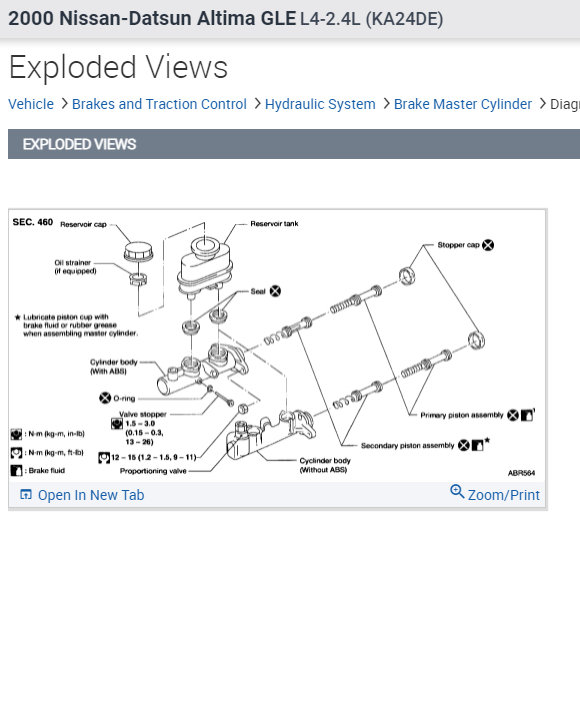

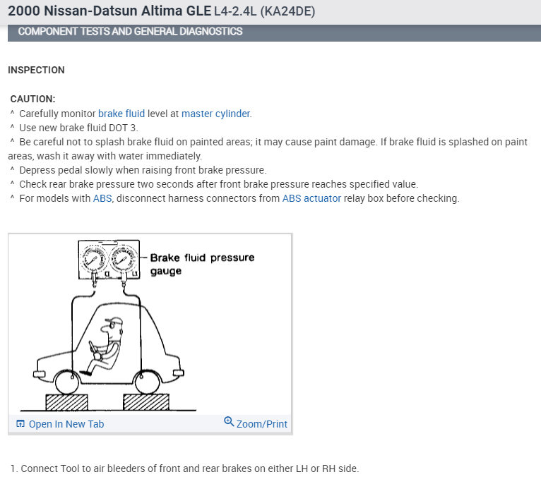

Not having fluid out while bleeding could be due to clog in the bake hose or faulty brake proportioning valve.
On this vehicle the proportioning valve can be built into the master cylinder or it could be a standalone unit.
The valve could fail and can stop flow to the brake.
https://www.2carpros.com/articles/how-to-replace-a-brake-master-cylinder
