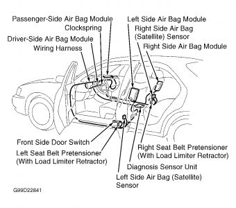

Due to minor flooding, the air bag control module is ruined. I have been told that it is under the center console but I haven't been able to see any screws to dismantle the console.
Question 1: How do I get to this thing?
Question 2: Is there anything special that needs to be done to make the new module work with the car?

Dave Is the airbag control module the same as the diagnosis sensor unit? If so, how do I get to it?

yes buddy the diagnosis sensor unit is the main control mdule for airbag systems on this vehicle .. you will need a T50 torx bit ...and once replaced with new.. have the vehicle's ECU (computer) read to clear any fault's .. if any.. before you start YOU !!!MUST !!! DISCONNECT BATTERY AND DO NOT TOUCH VEHICLE AIR BAG COMPONENT'S FOR AT LEAST 3 MINUTES

Before proceeding, See AIR BAG SAFETY PRECAUTIONS . Disable air bag system. See DISABLING & ACTIVATING AIR BAG SYSTEM .Disconnect driver-side and passenger-side air bag modules.
Diagnosis sensor unit is located under rear of center console box. See Fig. 1 . Remove center console box and disconnect diagnosis sensor unit connector. Remove and discard Torx bolts and remove diagnosis sensor unit. See Fig. 10 .
To install, reverse removal procedure using NEW Torx bolts. Tighten bolts in sequence shown in illustration and to specification. See TORQUE SPECIFICATIONS . Diagnosis sensor unit must be installed with arrow facing front of vehicle. Reconnect driver-side and passenger-side air bag modules and activate air bag system. See DISABLING & ACTIVATING AIR BAG SYSTEM . Check AIR BAG warning light operation. See SYSTEM OPERATION CHECK
