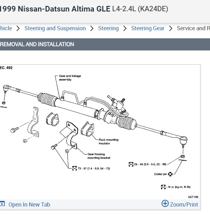

how to replace both inner and outer tie in rod form start to end?
Dec 5, 2007 at 8:25 PM
SERVICE WRITER
  • 9,123 POSTS

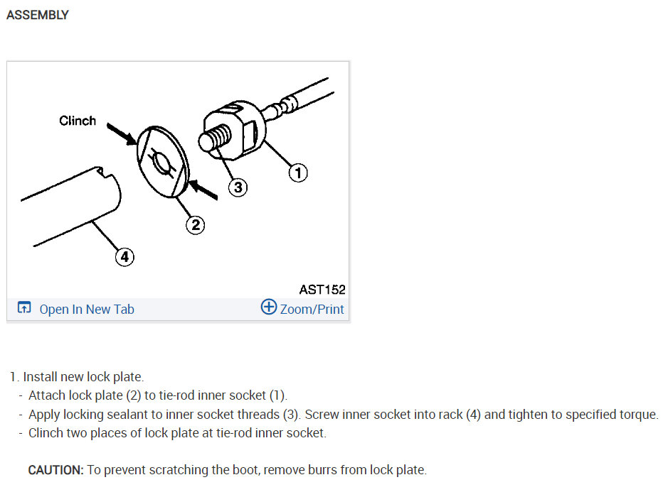

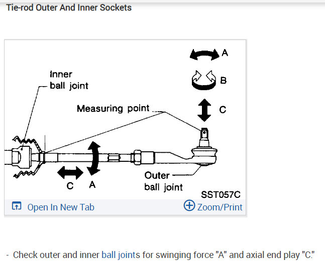

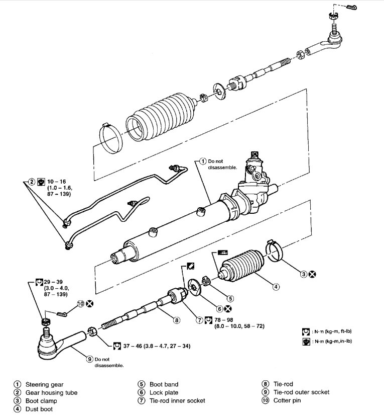

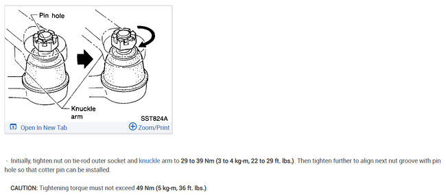

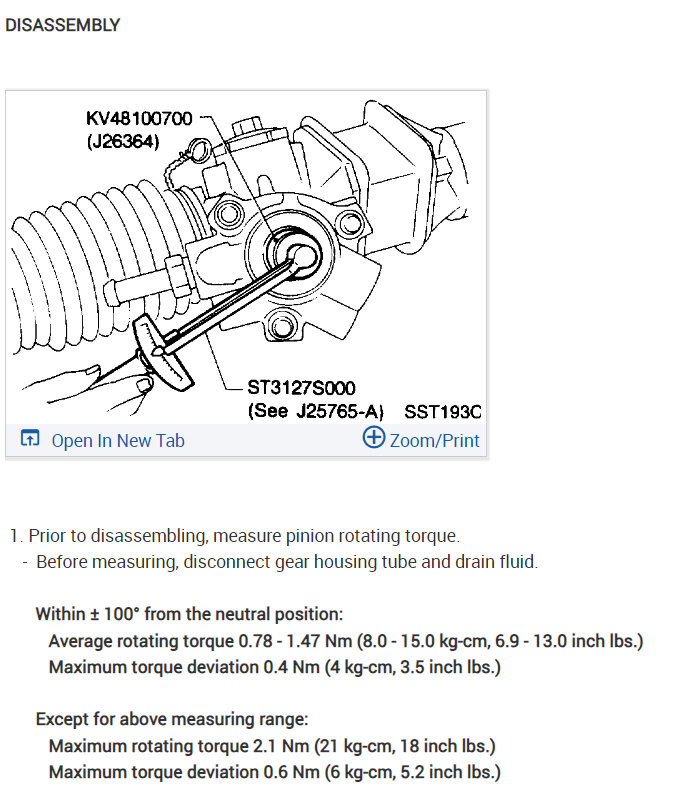

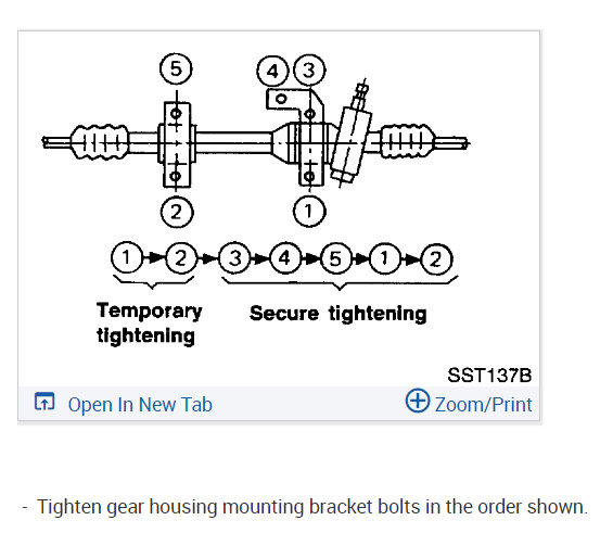

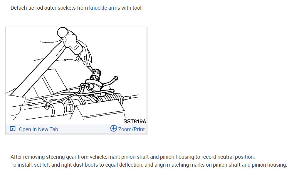

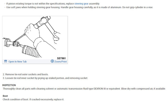

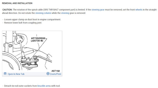

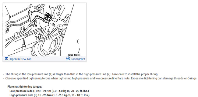

Here are the instruction on how to replace the inner and outer tie rod ends. You will need to raise the car up safety this guide can help.
Here is a generic guide to help you step by step with instructions in the diagrams below to show you how on your car.
https://www.2carpros.com/articles/tie-rod-end-replacement
Check out the images (below). Let us know if you need anything else.
