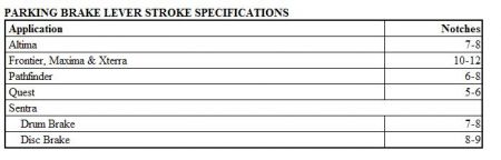

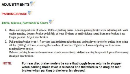

How do you adjust the emergency brake on a nissan altam with rear disc brakes ?

https://images.2carpros.com/forum/automotive_pictures/261618_Noname_1575.jpg
https://images.2carpros.com/forum/automotive_pictures/261618_Noname2_480.jpg
