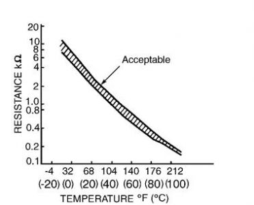

Suspect faulty IAT sensor. Check to see if IAT sensor is operating at correct voltage below.
https://images.2carpros.com/forum/automotive_pictures/261618_Noname_341.jpg

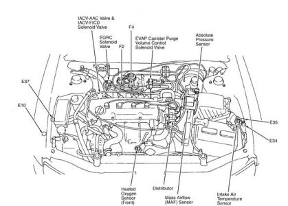

It is located on the left side of the engine compartment, in air intake pictured below..
https://images.2carpros.com/forum/automotive_pictures/261618_2_24.jpg
