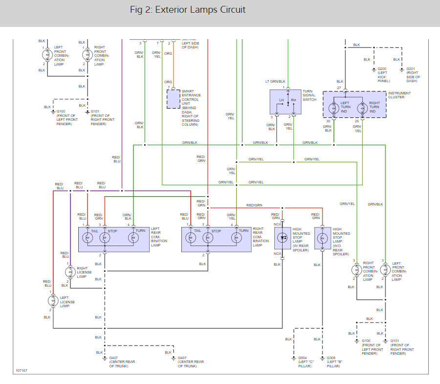

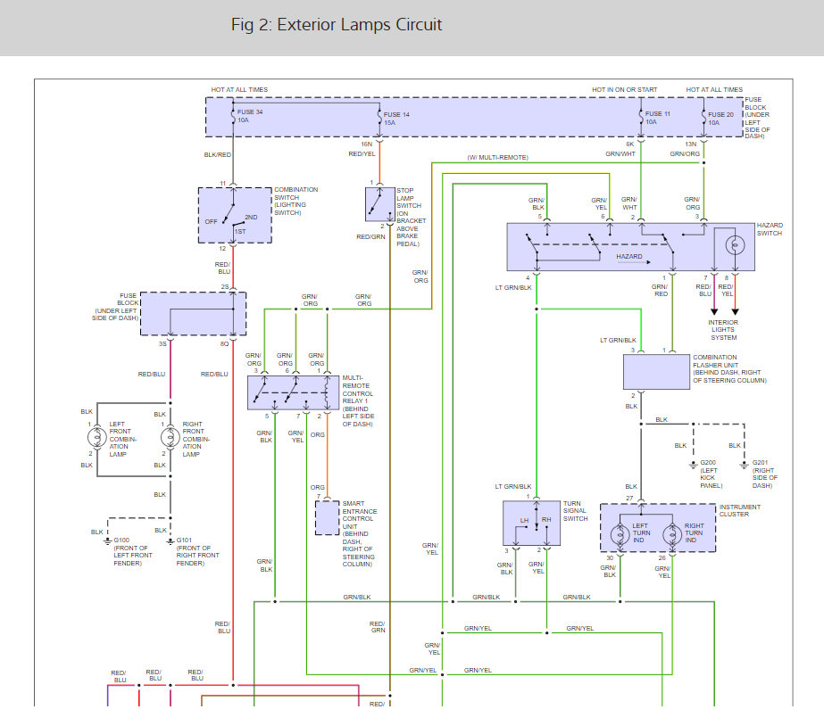

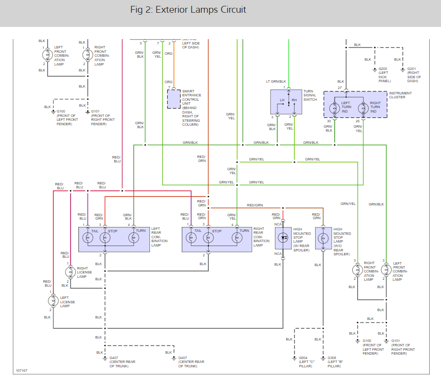

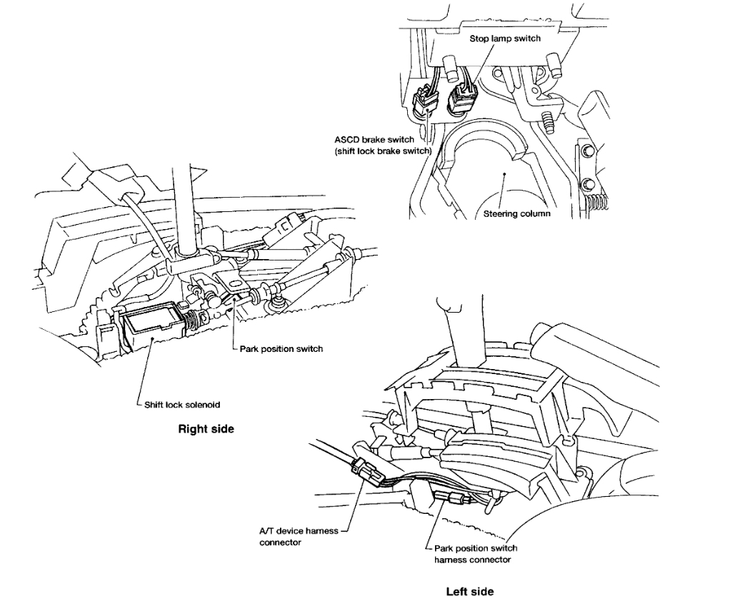

why does the stop lights stay on when car is off i checked everything and i have to take off the fuse for them to go off.?
Aug 4, 2010 at 2:48 AM
  • 110,248 POSTS
Have you checked the brake light switch?
Aug 20, 2010 at 3:14 PM
LEE JOSH
I have replaced the brake light switch and followed the wire all the way to the front and found nothing wrong with the wire. Family member wrecked the car before i bought it and after he wrecked it they started staying on. Can the brake shoes have anything to do with it?
Nov 5, 2018 at 7:00 PM
  • 55,684 POSTS
No it is the brake light switch keeping the lights on. Here is a wiring diagrams so you can see how the system works and the location of the switch so you can replace it or readjust it below. Check out the diagrams (below). Please let us know if you need anything else to get the problem fixed.
