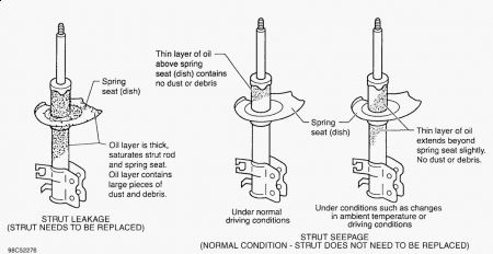

When I make a right trun or go up over a curb (into a driveway) there is a loud bang in the rear end. It sounds like a bowling ball or something shifting in the trunk (trunk empoty). I have visually checkd for support rods etc. loose but found nothing. Any suggestions?

With 136,000 miles, you are way past due for strut replacement. Here's a guide to when Nissan struts need replacement:
https://images.2carpros.com/forum/automotive_pictures/62217_Struts_1.jpg
