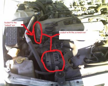

A few days ago my engine started to make a rattling noise, almost as if a part got loose and was knocking against another metal part as I was driving. (I have checked and nothing is loose) The noise wasnt consistant until this morning. There has also been a whine that becomes louder as I accelerate. The whine is not constant and usually stops after driving for 10 miles or so.
I'm unsure what to do besides take it to a shop and have my bank account drained.

Ok before taking it to a shop I would get a long screw driver that you can use as a stethiscope to listen to the engine. You put the screw driver on the part you want to listen to and put your ear to the other end and listen. I would start with the valve cover and work my way around the louder the noise the closer you are. Let me know what you find.

The loudest noise seems to come from the two places i circled in the pic (with the screwdriver). But to the "naked" ear, it seems to come from down by the belts...couldnt get there with the screwdriver i had.

Ok with what you have discribed to me I would say that your timing chain is streched and making most of your noise.
As for the alt. I would take it off and take it to a parts store and have them test it and if it makes noise off the car then replace it and see how much difference that maikes.
I would also go to the parts store and buy a stethescope so you can better hear and listen and have better reach. I would like to make sure that that the water pump isn't making all your noise before saying change the timing chain and guides and such. Get back to me
