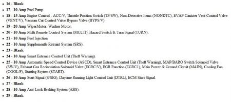

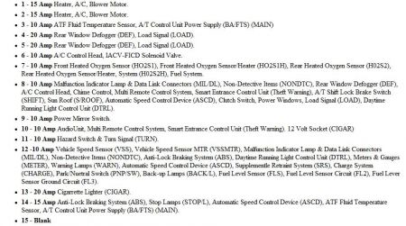

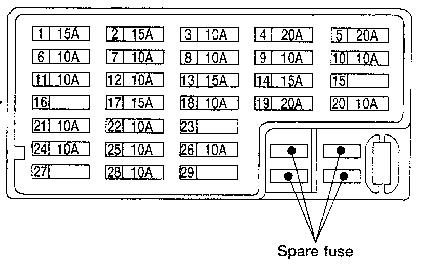

where can I get the under dash fusebox diagram for my 98 altima. The sticker on the fusebox cover is missing. I went to my local nissan dealer's parts dept & they said they couldn't help me.
Feb 6, 2008 at 12:31 PM
FISHERMAN
  • 937 POSTS
Hello !! Here is your schematic:
https://images.2carpros.com/forum/automotive_pictures/576_111_1.jpg
https://images.2carpros.com/forum/automotive_pictures/576_1_1.jpg
https://images.2carpros.com/forum/automotive_pictures/576_11_1.jpg
