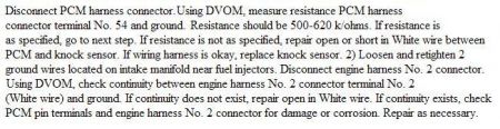

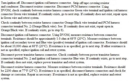

Car has been stalling out. Took to mechanic, said prob was ignition relay. Replaced distributor Still stalling running even rougher. also seems to be Having probs at 2000 rpm. Engine runs smooth above or below 2000 rpm. Did the self diagnostic test and got the error code "21, 34" or 2 long 1 short, and the 3 long 4 short. Disconnect battry for 24 hours to clear codes. Started car back up same result, checked the diagnostic, also same result. Looked up codes in the haynes and cant find any to match. m i reading the code wrong or is there something else i am missing?

reading flashes wrong. that will actually be MIL codes 0201 and 0304 . 0304 is indicating a fault with your Knock Sensor while 0201 is indicating fault with the Ignition Signal Circuit. Perform the following tests to troubleshoot the issues.. TROUBLESHOOTING 0201
https://images.2carpros.com/forum/automotive_pictures/261618_Noname_1503.jpg
TROUBLESHOOTING 0304
https://images.2carpros.com/forum/automotive_pictures/261618_Noname2_446.jpg
