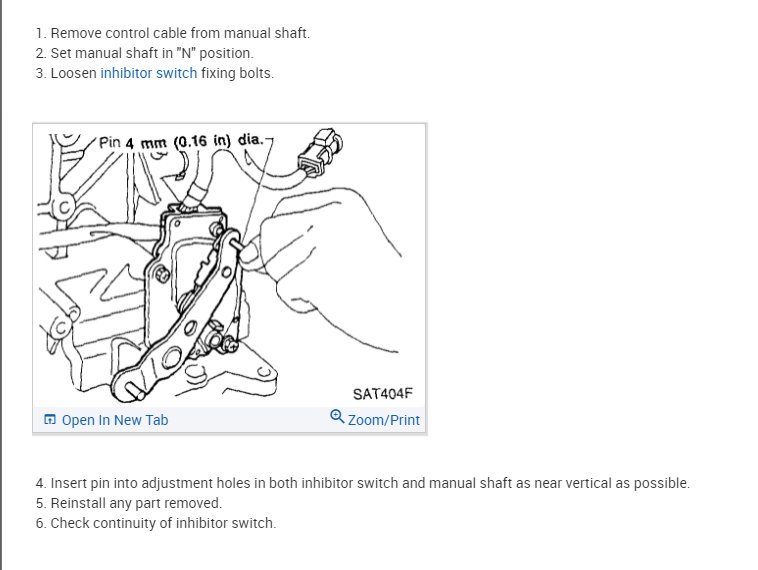

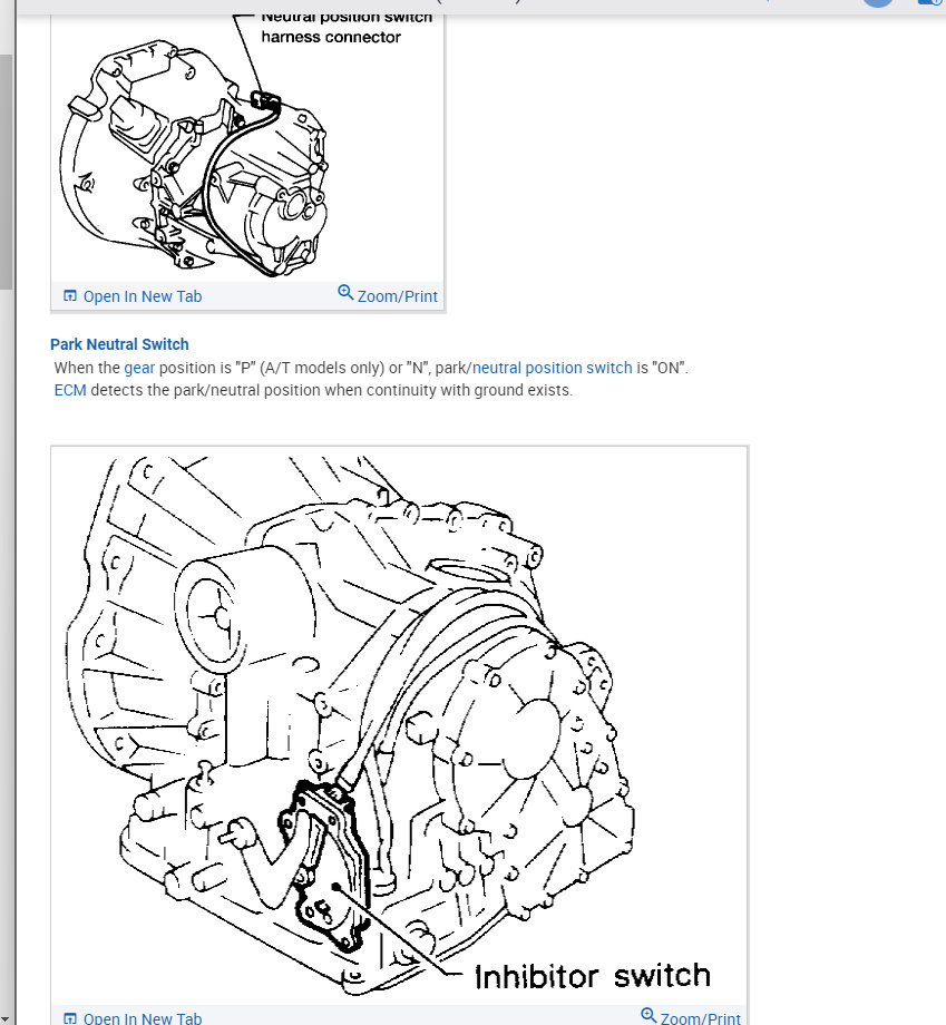

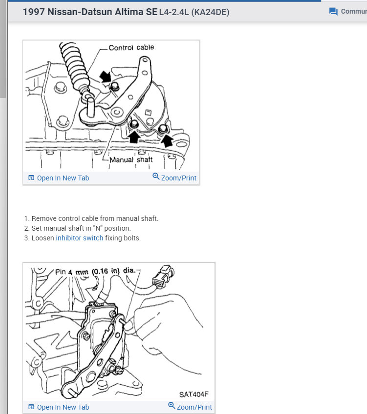

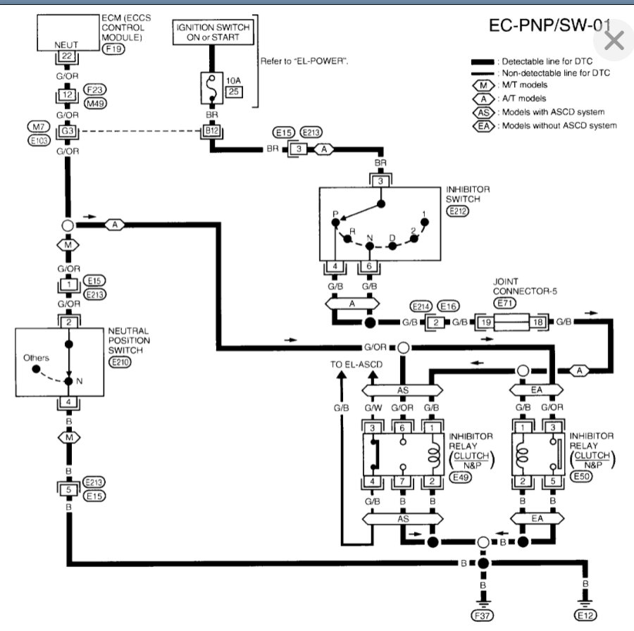

I will attach the location of the switch, but these are a couple guides that will help with testing to find out it this switch as failed. Basically, you need to check voltage across the two pins and find out if there is voltage.
If these is then the switch is closing and is okay.
Below you will find the location, adjustment procedure, and wiring diagram.
Please run through this and let us know what you find. Thanks
