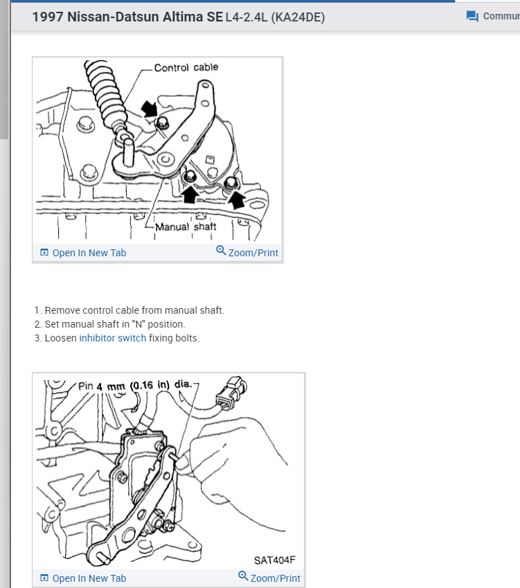

I need step by step directions preferably with pictures on how to locate the neutral safety switch
1997 NISSAN ALTIMA
200,000 MILES • 4 CYL • FWD • AUTOMATIC
MOMMY_NOEL
I need step by step directions preferably with pictures on how to locate the neutral safety switch... and how to test it... pictures would be amazingly helpful!!!
May 22, 2010 at 12:48 PM
  • CAR REPAIR CONTRIBUTOR

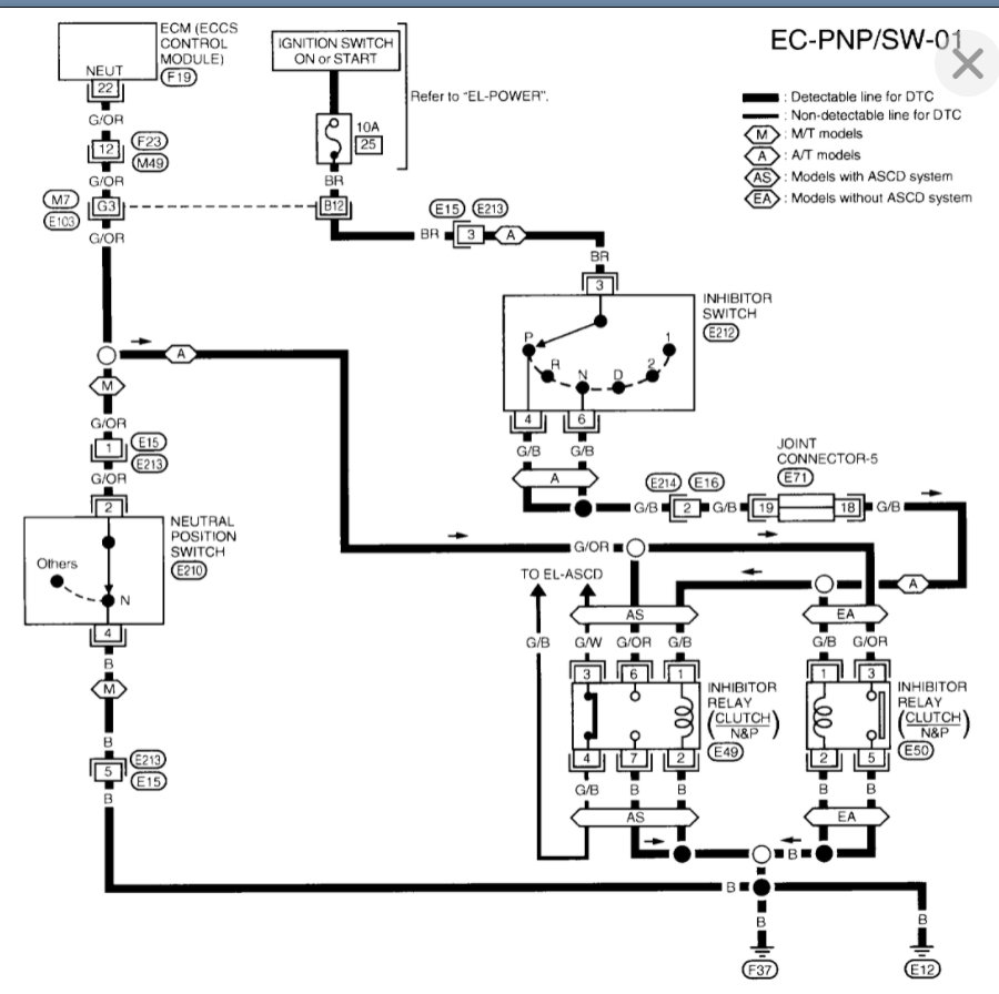

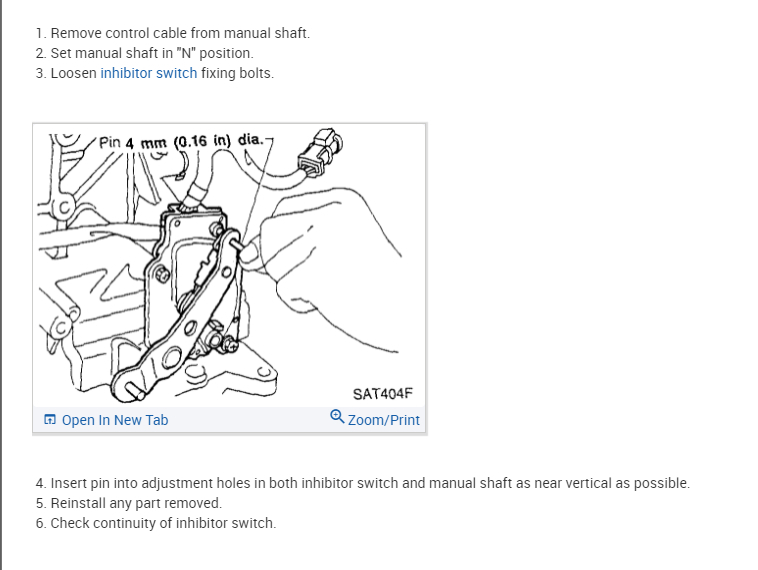

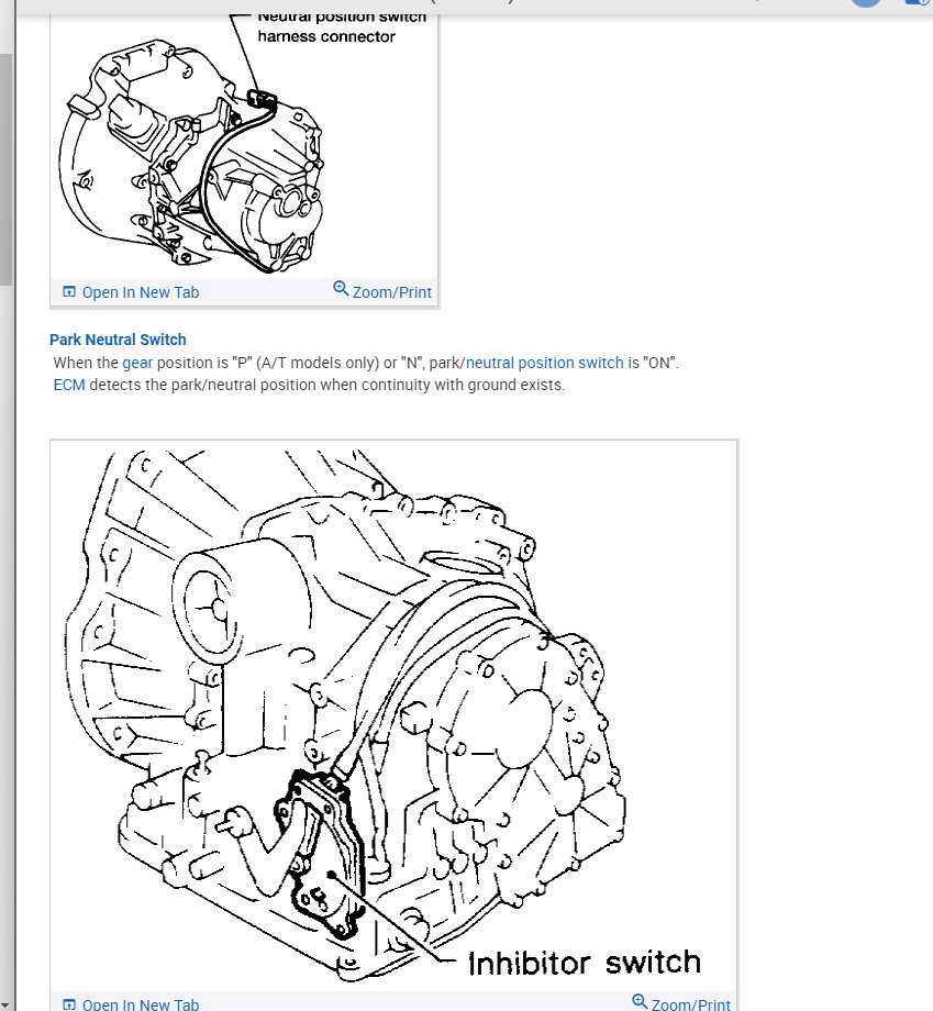

I will attach the location of the switch, but these are a couple guides that will help with testing to find out it this switch as failed. Basically, you need to check voltage across the two pins and find out if there is voltage.
If these is then the switch is closing and is okay.
Below you will find the location, adjustment procedure, and wiring diagram.
Please run through this and let us know what you find. Thanks
