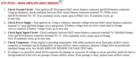

My car won't pass emissions due to mass or volume air flow circuit. code p0100. What needs to be repaired for it to pass emissions?
