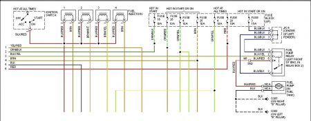

Is there an "Inertia Cut Off" switch on a 1997 Altima? If so where?
Also is there an on-line wiring diagram for the same car?
Thanks
Mar 11, 2010 at 1:48 AM
BLUELIGHTNIN6
  • 16,542 POSTS
no it does not have an inertia (fuel cut off) switch and a partial wiring diagram of fuel system is below. if having issues with fuel pump then check for faulty fuse and fuel pump relay
