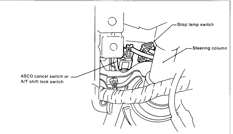

As i was saying brake lights will not turn off. Drains battery in a few hours.

Hi there,
This will be an out of adjustment or a faulty brake light switch, this switch is located at the top of the brake pedal. Here is a diagram so you can see what you are in for when replacing the switch
Mark (mhpautos)
May 20, 2010 at 3:21 PM
JMAZE
Thanks you it was the switch I bought one for $19.00 and installed it (little tough) but the brake light s work perfect thanks, I love this site.
