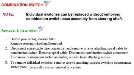

How do you change the turn signal switch on a 1995 nissan altima
Jun 23, 2010 at 11:08 AM
BLUELIGHTNIN6
  • 16,542 POSTS
https://images.2carpros.com/forum/automotive_pictures/261618_Noname_2351.jpg
