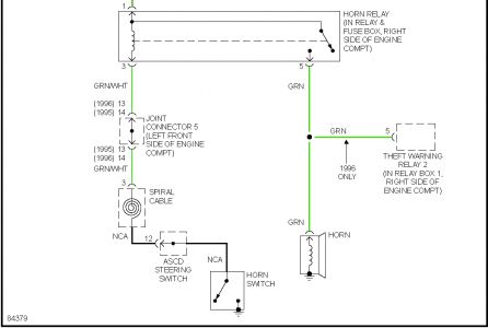

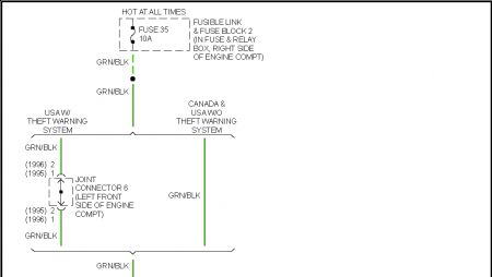

Need Wire Diagrams for fixing an open circuit along my Horn wiring

Thank you very much! All i know at the moment is that there is no power in the fuse box for the horn. Any idea where to start looking?

check the fusible link
