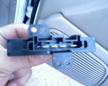

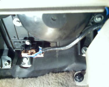

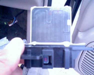

I recently purchased a nissan altima it runs perfect only the air condition does not work not even does it throw or blow any air from the vents. Is it like discharged or is the blower motor gone bad relly I just wanna now why isint there even any air comining frome the vents please I need to know.?

So, you are saying that when you turn on the blower no air comes out of the vents?? If so, then you need to check if you are getting ground and power to the blower motor.

the usual problem when ac air or heat doesn't flow from the vents even when turned on is a bad blower motor resistor. the pics are that of the 1995 altima but are typical of the flocks. naturally the resistor is located next to the blower motor, under the glove compartment, and held by 2 bolts. they are easy and cheap to replace and can be gotten cheapest by rockauto.com
