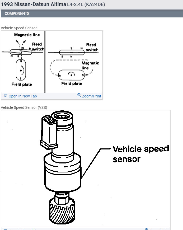

Where exactly on the transaxle is the speed sensor for this car?
1993 NISSAN ALTIMA
150,000 MILES • 4 CYL • FWD • AUTOMATIC
KALOPALOT
Oct 11, 2009 at 4:03 AM
SQM
  • 6,383 POSTS

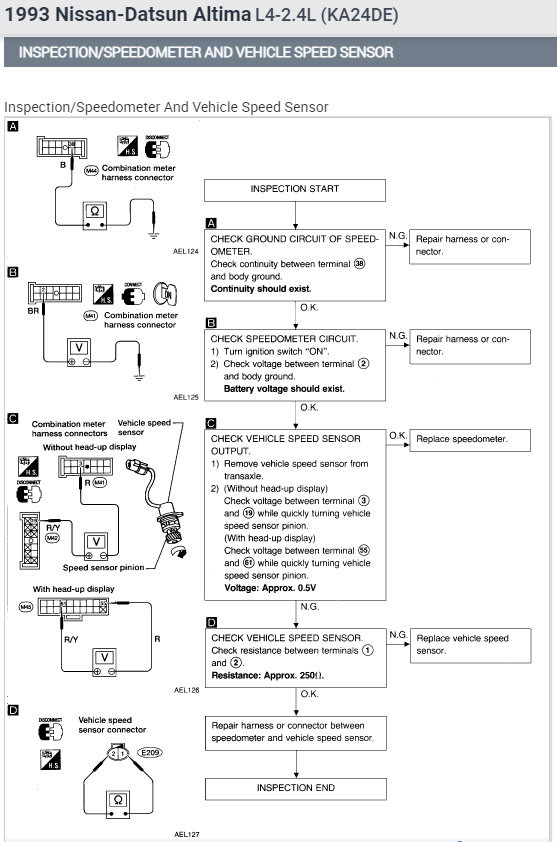

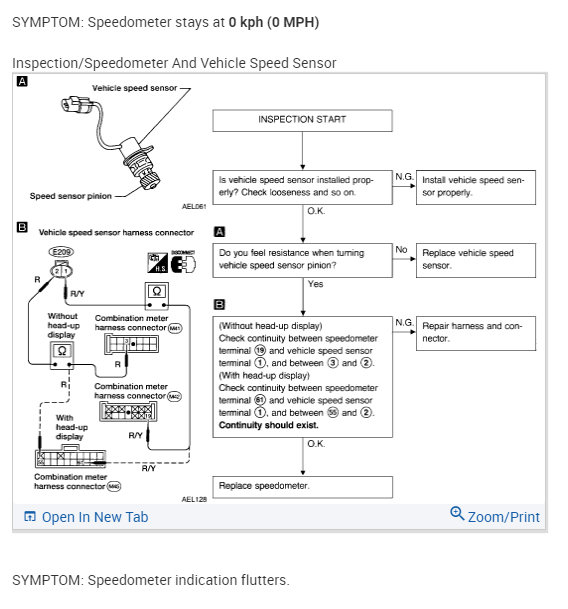

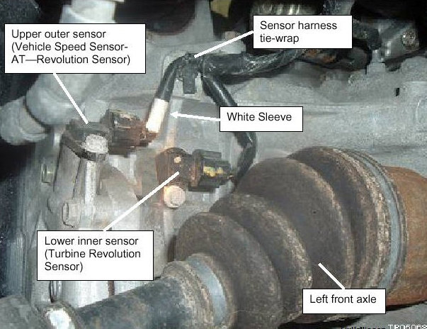

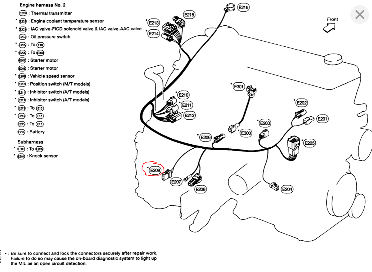

The vehicle speed sensor (VSS) is located on the transmission housing.
The VSS measures the transmission shaft rotation and sends that information to the ECM and that gets translated to the speedometer gauge.
I have attached the diagrams for the VSS as well as diagnostics for your reference.
